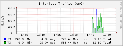

Read from the FreeNas after a 180MiB/s burst down to 30MiB/s or less, average 20~50MiB/s although Ubuntu was more stable and faster with 80MiB/s.
iperf3 tests
FreeNas to Slackware 19,6Gb/s
Slackware to FreeNas 6,65Gb/s
FreeNas to Win10 2,43Gb/s
Win10 to FreeNas 1,64Gb/s

After reading some posts about performances, I disabled the compression. This had no measurable changes. I then changed the network adapter for the Win10 VM from VMXNET to E1000. iperf3 improved a significantly in one direction:
FreeNas to Win10 2,54Gb/s
Win10 to FreeNas 4,32Gb/s
Going back to VMXNET also reduces the speed again.
