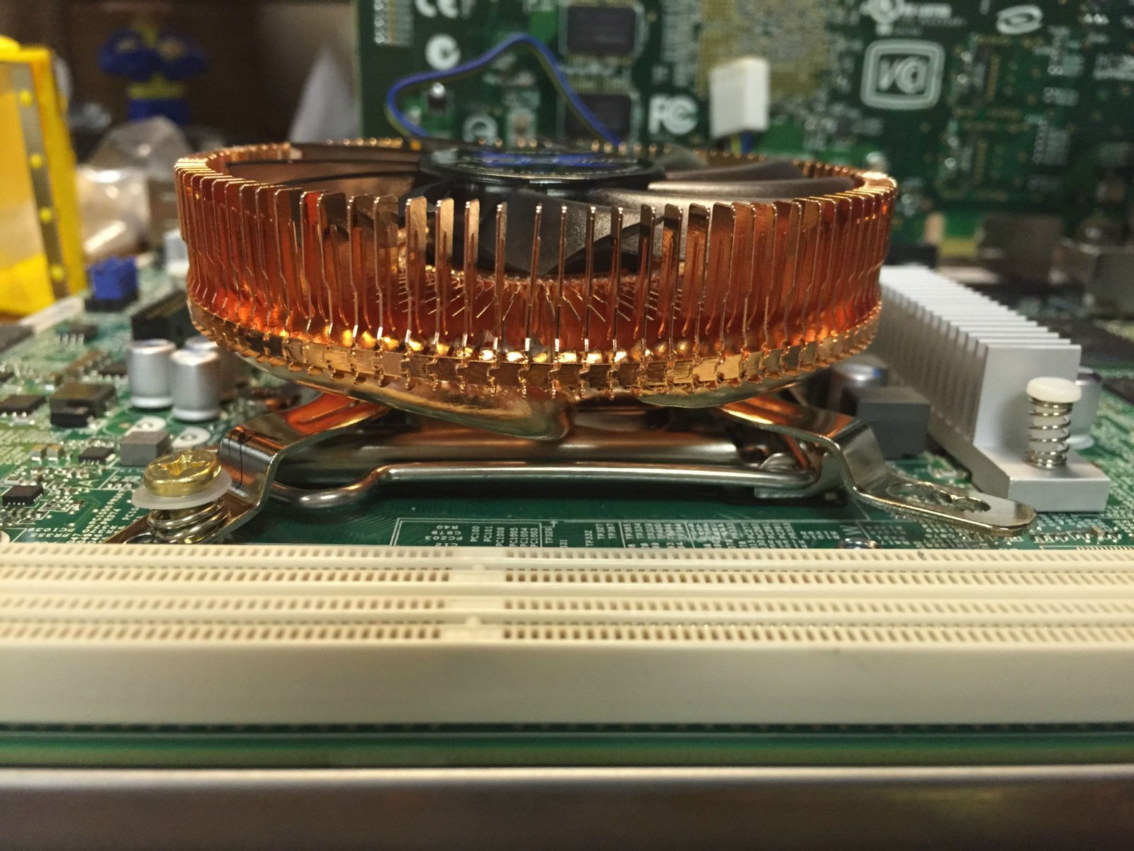

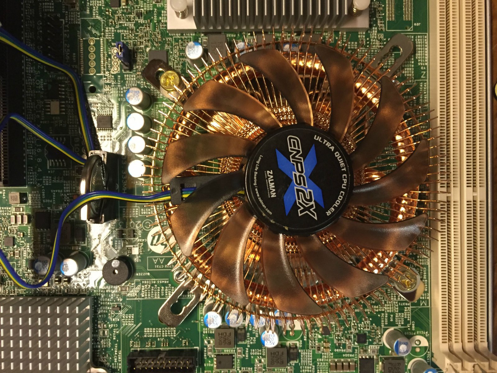

I might do a similar fan for my 10Gb card in my Micro server. I already picked up the 16Gb of RAM, and a Xeon. I used the Zalman cooler i saw in another thread on the same site you linked. I was deff considering getting a SD card and installing ESXi on that and that would give me full use of my 2Tb hdds but i realized i dont care a hell of a lot lol. I got my loaded with 2 2Tb WD RE4 drives in RAID1 using the onboard controller, i got all the firmware updated soon as i unboxed it, and i plugged in a iLo 4 adv license because i hate not having iLo features.... How are your temps? Did you change out the stock fan that pulls air through?

I'd like to swap out the stock exhaust fan with a better / quiter one but they went and used some terrible 6-pin proprietary connector on the motherboard, and now while people can and have spliced into the cable to add their own I'd rather not bother doing that since the stock fan is fine as is really, and as soon as I move the server into another room I'll bump the speed up anyway because sound won't be an issue. I don't have any temp readings from before I started adding fans etc but I'm going to wait for the thermal cement to dry on the northbridge tonight and do a check of them all tomorrow.
