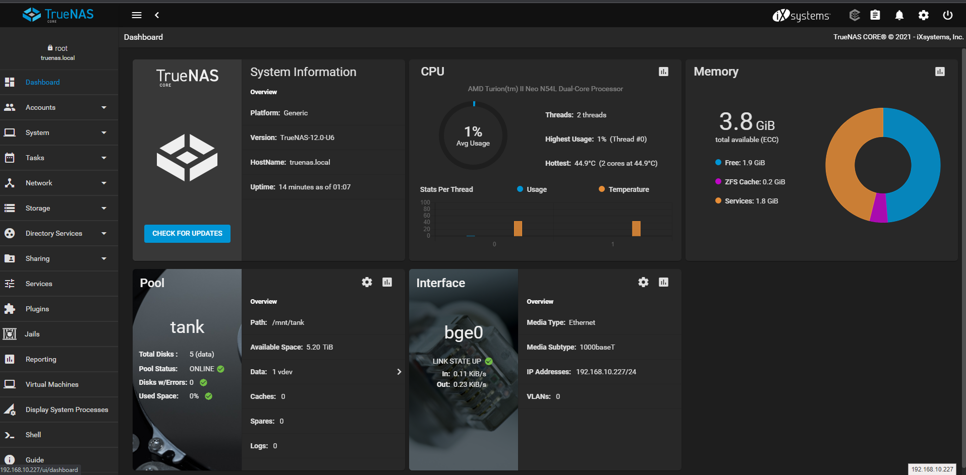

juuce
Sep 16, 2021
5
Current Dashboard
Truenas core 12
4GB EEC RAM
4 disks in RAIDZ2
USB to SATA cable running OS on 120GB SSD
Original issue of network down seems to have disappeared...???
See screenshot for working environment...
