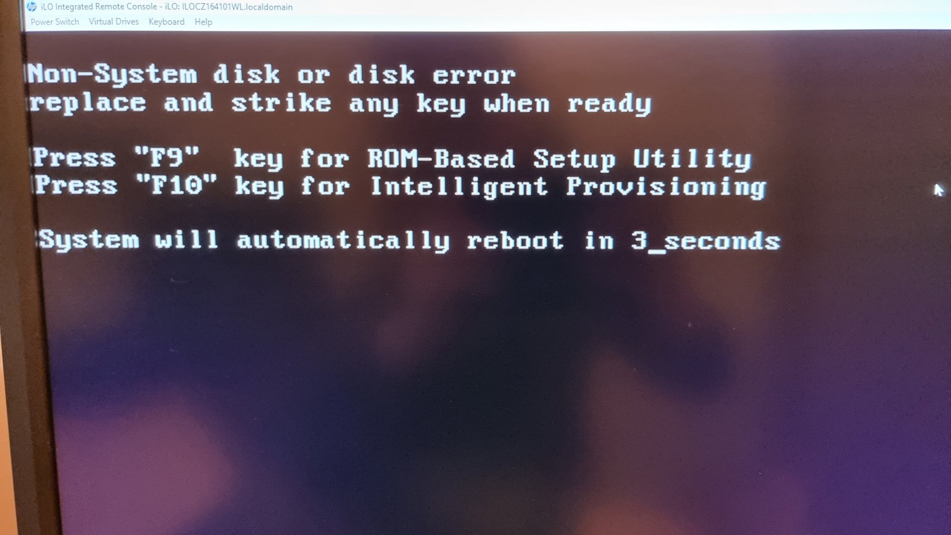

The microserver complains about "non-system disk or disk error"
The interesing thing is if I install "core" first I am then able to install "scale" on the provisor I don't format the USB HDD (upgrade). This then gives me the option to select "scale" on boot and it runs through migration process. I would prefer to install scale without going through the migration process.

Yeah, so, you need to do what it's suggesting, which is to go into the ROM-Based Setup Utility and tell it what the correct boot disk is.

The correct boot drive has been selected within the ROM-Based utility.
If there was an issue with the settings would I be able to boot from "core" installation?

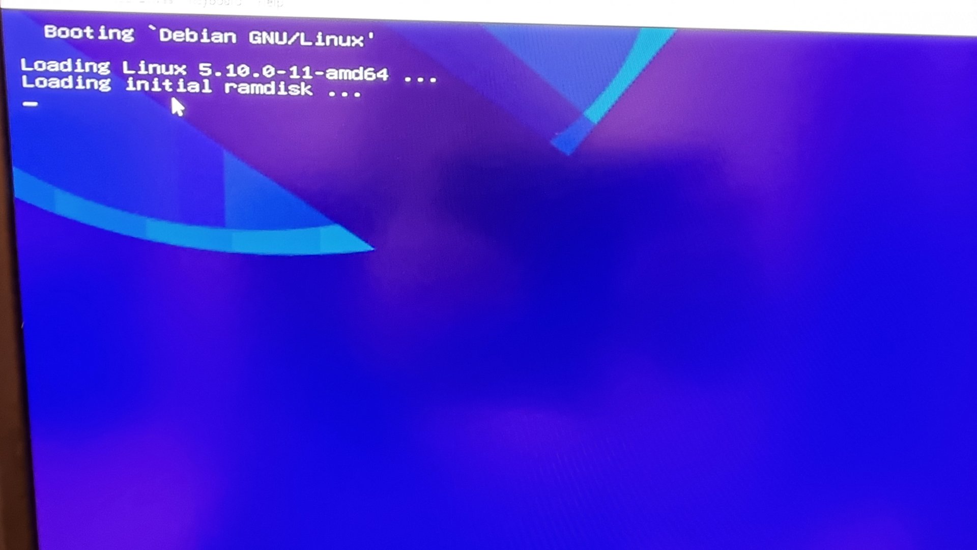

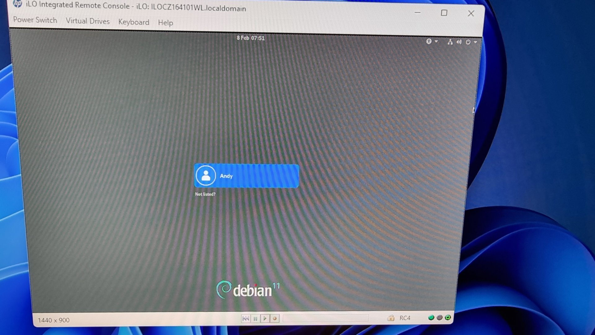

I can confirm debian installs and boots correctly.
I will try report this on Jira.

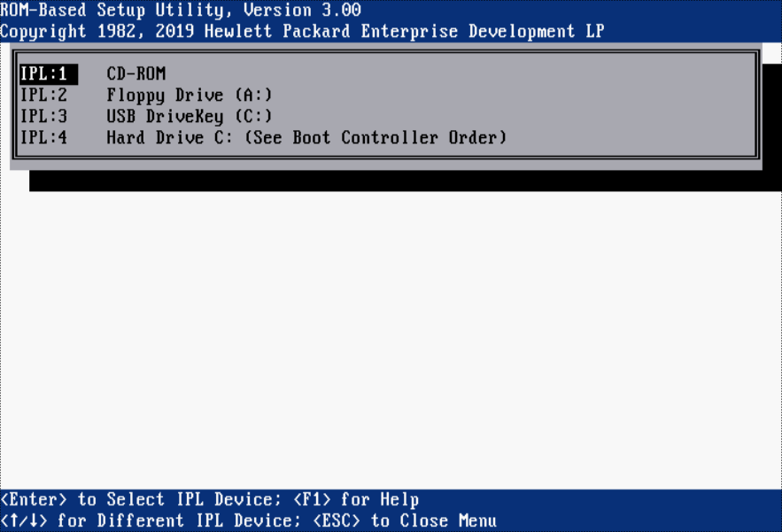

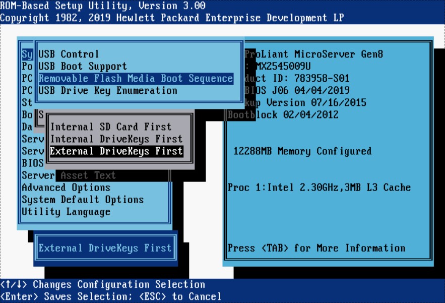

It sort of sounds like your setup might be similar. Is there anything I can take pictures of from my BIOS to see if any of my settings might be different from yours? At the very least I thought I'd take pictures of the BIOS settings from my system from the same menus you had. Here those are:
The only difference I see is that my system has the External DriveKeys First selected in the Removable Flash Media Boot Sequence section.
If there's anything else I can take a picture of, let me know and I'll do that.

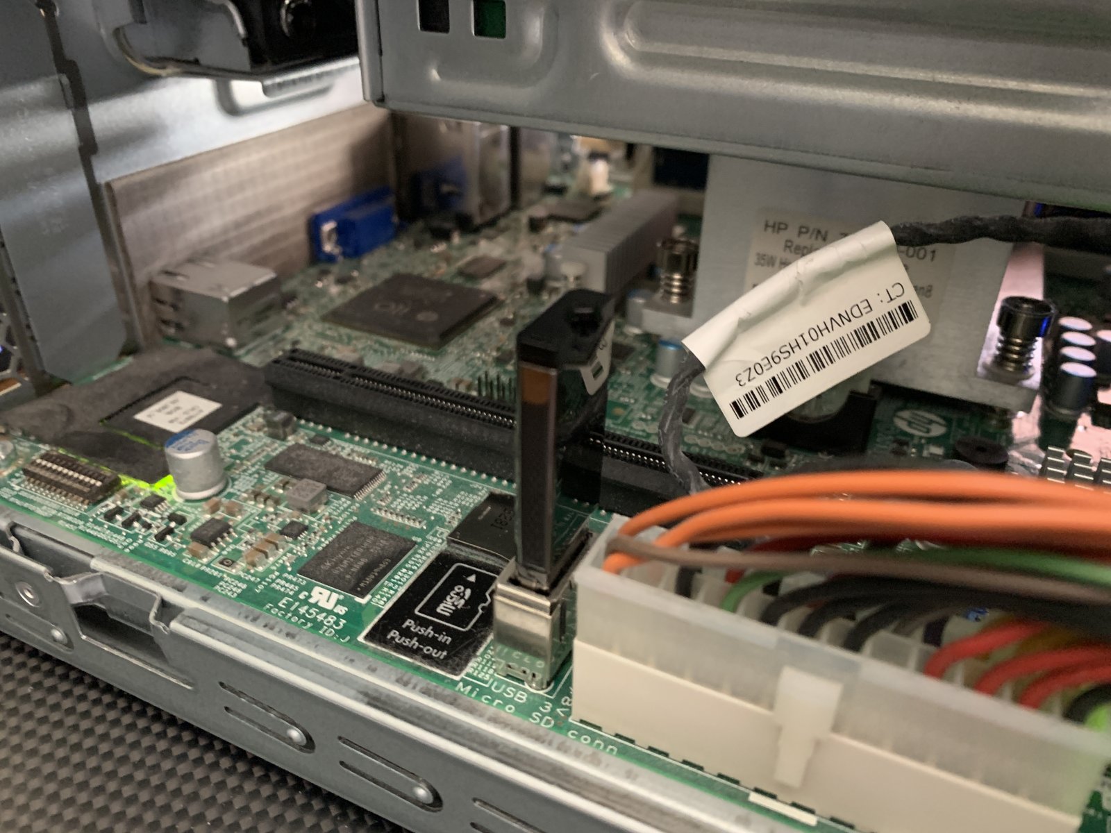

I've heard of people having success using a USB thumb drive to hold the boot loader and then have the TrueNAS OS on a SATA SSD connected to the optical SATA port, but that seems like a lot of extra work. I'll see if I have any success with a USB enclosure similar to yours. It seems like a cleaner option.
It's actually pretty easy. All you need is a live Linux on an USB-stick and an USB-stick or micro SD card plugged into one of the internal ports.
Then it's about 10 lines of terminal commands to install Grub on the internal device of your choice and create a chainloading mechanism to boot from the ODD port.
Hint: Remove all other disks when doing this. Makes it much easier and safer to choose the right installation target for Grub.
I've done this before with a G8 using a leftover micro SD card from a trashed cellphone. Works flawlessly.

A good guide doing this can be found here. Although it's in German it's mostly shell commands anyway and the rest should be understandable using a translator like deepl.com. Also he provides a ready to flash image file at the beginning of the page so basically you must only edit the Grub config for your number of drives.
