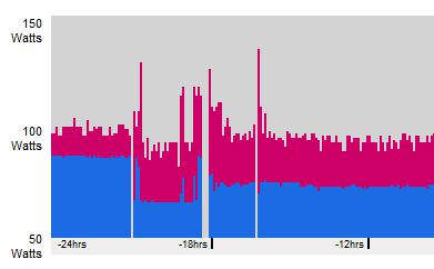

I won't really settle for "windows can't be run in a VM just deal with it" argument. To me it's obvious *something* is causing it and I want to figure out why.
I did disable HPET and it kinda seem to have solved the single core AME taking up lots of power and is more in line with what I would expect "house keeping" and general windows overhead you described.
You can see the difference, running VM on the left, VM off after first gap, HPET disable for the rest with VM on. Not perfect but better.
The quad core VM is still very much stubborn.
*edit* I will also take a look at Scale and see if that can solve the problem. Probably not gonna touch Hyper-V but who knows.
