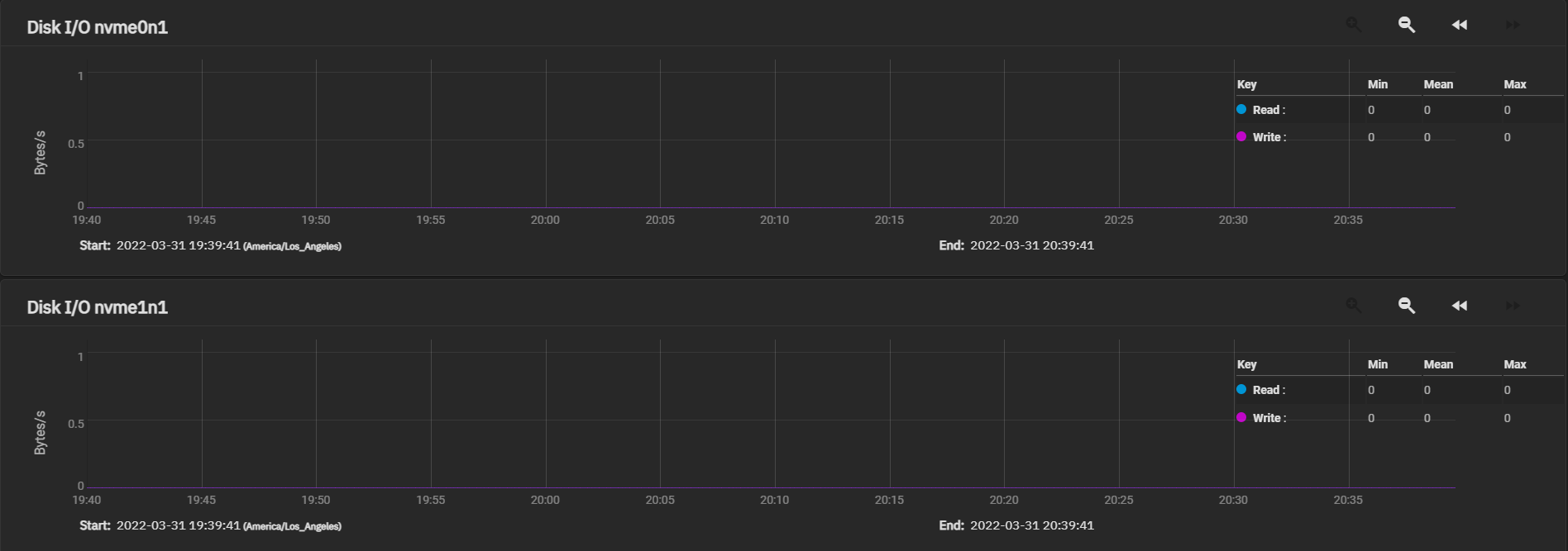

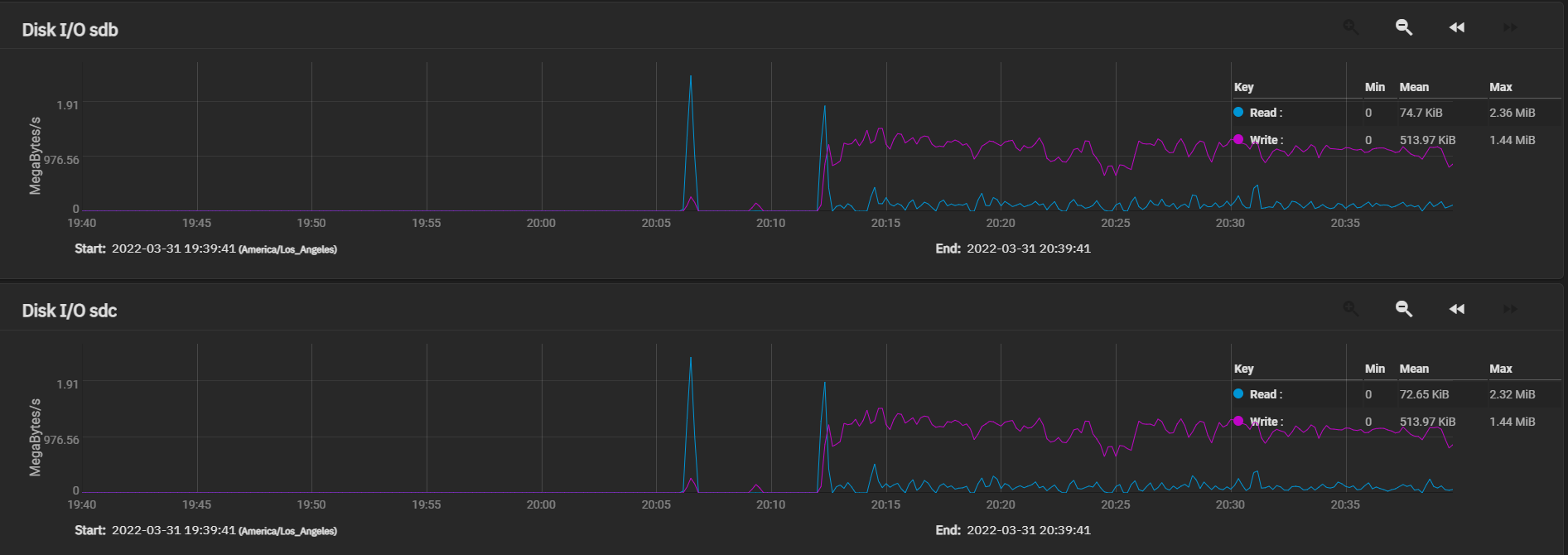

How can I determine how effective the write caching added by the mirrored NVME or the metadata on the mirrored SSD?

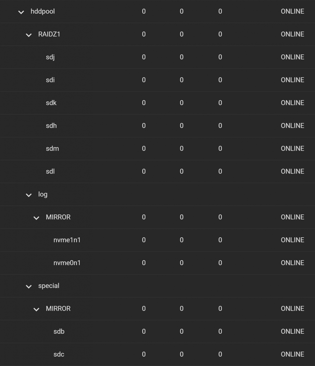

I created a pool as this.

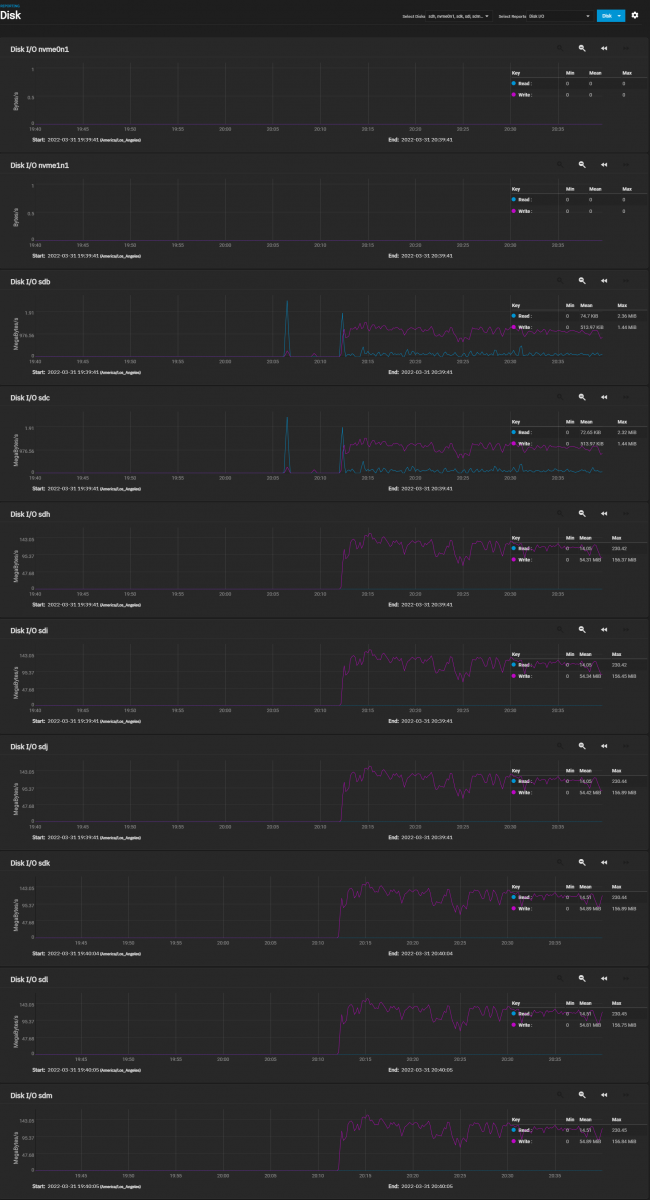

The optane NVME log mirrored pair do not seem to be used when streaming large files to a share on the hddpool
The metadata mirrored pair see some activity

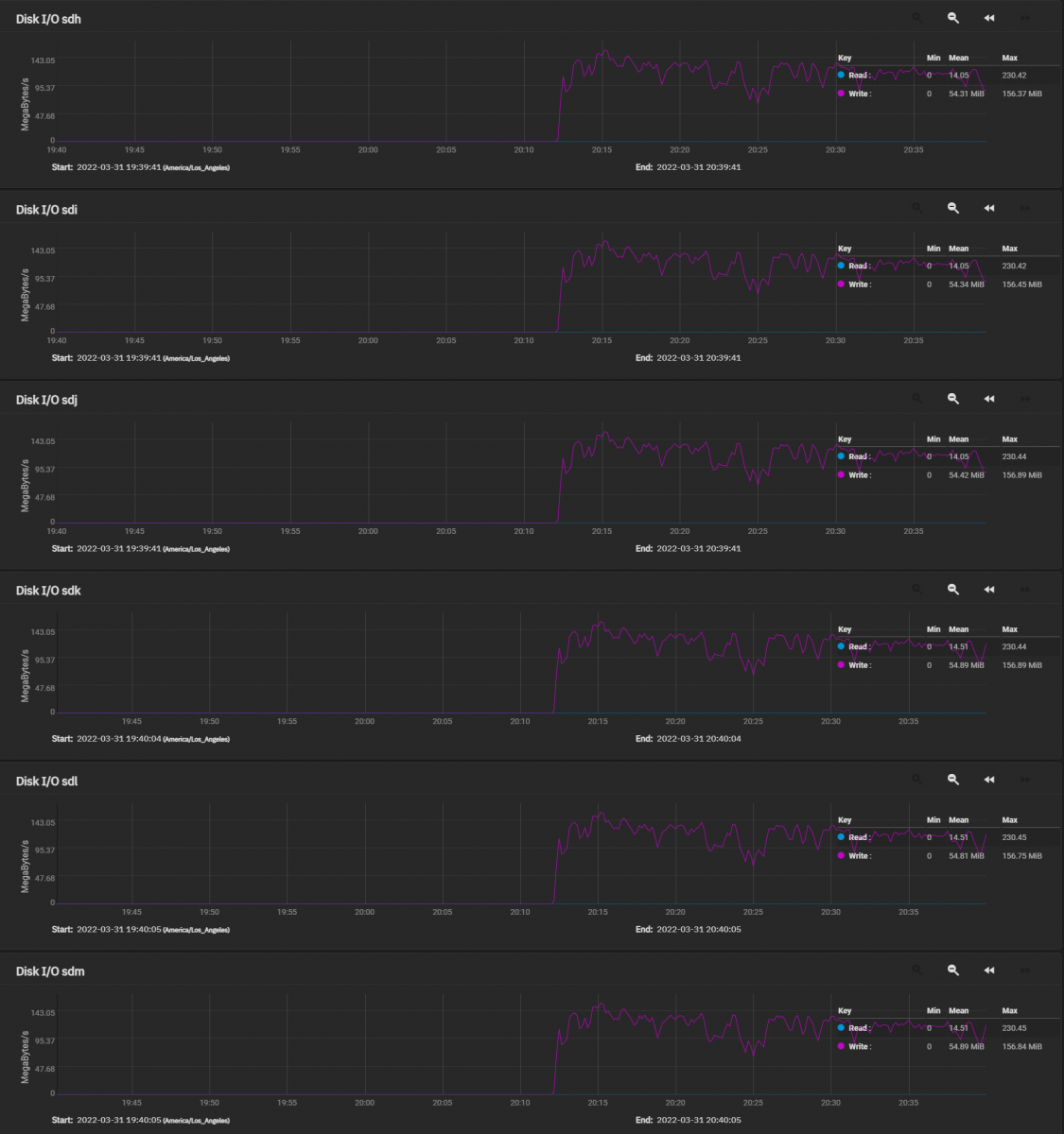

The 6 data disks in the vdev seem busy

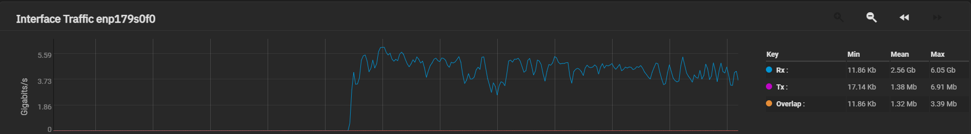

The network seems to show fairly consistant performance if not particularly amazing fast.
You should really understand more about what SLOG is and why you would use it before expecting to see anything "improved" by using it.
Sync writes are the only things that will be "helped" by SLOG. Apparently your large file streaming is async.
The typical use-case for SLOG is when you must do sync writes and you don't want to lose anything in the event of a power cut/failure.
Since you're using RAIDZ1, you're clearly not trying to do block storage (at least not the right way), so you probably don't need a SLOG.

SLOG only needs to maintain a few transaction groups worth of data. You will never have a lot of data in it, never more than fifteen seconds worth.

Here is the zpool iostat -v hddpool (while writing a few TB to the SMB share)
SMB does not do synchronous writes so your SLOG device is not used for SMB sharing.
An SLOG is not a write cache. An SLOG is not a write cache. An SLOG ...

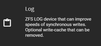

yikes. The GUI refers to the log volume as a write-cache.

2,947
It does, and its sort of wrong - its very difficult to describe a SLOG in what is effectively a sound bite. The first sentence is correct, the second is iffy although it can be removed.
