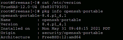

root@homenas[~]# cat /etc/version
TrueNAS-12.0-U4 (8e83079305)
root@homenas[~]# pkg info openssh-portable
openssh-portable-8.4.p1_4,1
Version        : 8.4.p1_4,1
git log for openssh-portable
$ git checkout TN-12.0-U4

15,504
also apache version is still 2.4.46
Where? I don't see that Apache is part of FreeNAS in any way; it uses Nginx for its web server. And even if it were part of FreeNAS, the version that you say is there is well later than the identified vulnerable versions.

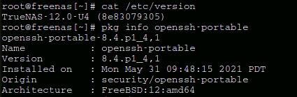

HEAD is now at 94e0b32c0289 Merge pull request #1041 from truenas/openzfs/12.0-stable
$ git log security/openssh-portable/
commit 3c654e6aca0e826ca94e09fbbfc9416487c13f2e
Author: themylogin <themylogin@gmail.com>
Date:   Thu May 13 22:35:23 2021 +0200
    Fix security/openssh-portable
commit 7bbad66d3744bb51479aa2a41b531e1c0a34b9d9
Author: Bryan Drewery <bdrewery@FreeBSD.org>
Date:   Thu Mar 18 20:49:44 2021 +0000
    Add limited patch for CVE-2021-28041 from upstream.
thanks anodos, i also got the same result.
However, when i do ssh -V i still see the old version, is there a way to remove it ?
