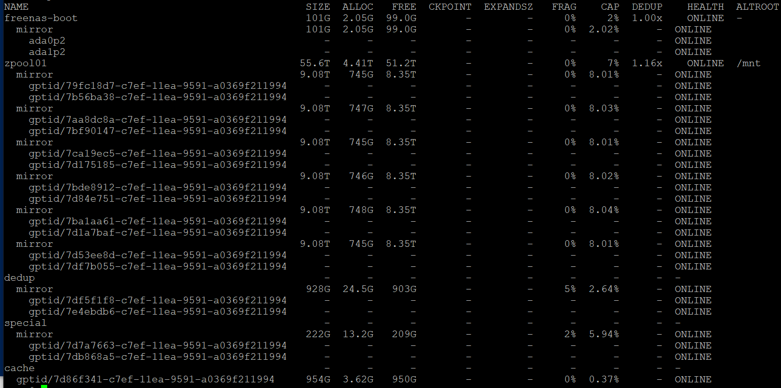

My configuration...
1x 2-disk mirror 120GB SATA SSD (Supermicro DOM) for boot
6x 2-disk mirrored 10TB spindle (WDC Gold) vdevs
1x 2-disk mirror 1TB nvme (Samsung EVO 970) dedupe vdev
1x single 1TB nvme cache (Samsung PRO 950)
1x 2-disk mirror sata ssd 240GB (Intel DC-series) special vdev
dedupe is on at the root of the pool, default compression is also enabled.
This gives me a pretty good breakdown when using zpool list -v to show allocations / usage among the VDEVs:
My usage by data footprint is mostly SMB shares with some VM on ZVOL LUNs; to that, system is entirely doing replica data/snapshots from an 11.3 box without workloads on it directly right now, but I have done so with the VM workloads (moved it back due to a snapshot deletion issue where it stalled the VMs during the snapshot deletion process)
My takeaway from this and based on what I've seen of the disk utilizations....
A) Special VDEV does NOT, out of the box, get hit that hard in terms of IO or consumption. 13.2G allocated/consumed based on 4.41T of data (roughly...that may be a deduped number). That said, out of the box, "small IO" is not part of the equation; only metadata gets written to the special VDEV, but if Dedupe is used, and no Dedupe VDEV is configured, then Dedupe is also handled here too.
B) Dedupe VDEVs gets POUNDED; all said. Tons of IO; and the dedupe tables are a bit larger than what I'd expected.
Just providing this to give some real-ish world numbers as to what the dedupe/special allocations vs actual storage would look like; though, different workloads would slide numbers around quite a bit.

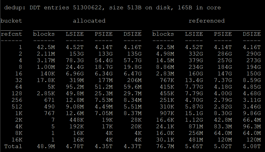

Also, my dedupe stats:
