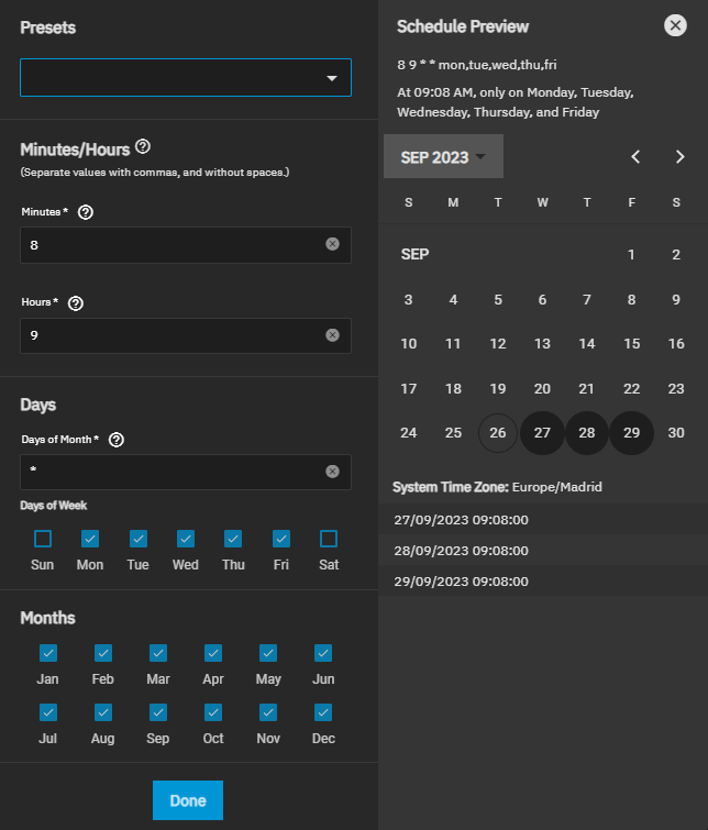

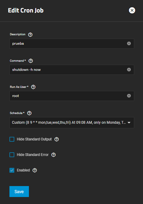

idtechno
Sep 25, 2023
Hello, I have the same problem, I created a cron job to close at the scheduled time but it is not working. When I run it manually, by pressing the play button, it works. Have you solved it? I tried many commands and nothing.

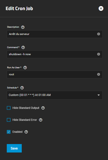

thomas.bst
Oct 13, 2023
Hi everyone,
I solved this problem by setting my BIOS clock to UTC (instead of my local timezone) and configured a post-init command (systemctl restart cron) to restart the cron service after the system startup. After making these adjustments, my cron job to shut down my NAS works perfectly. Below are my job settings:
OS Version: TrueNAS-SCALE-22.12.4
Thomas
