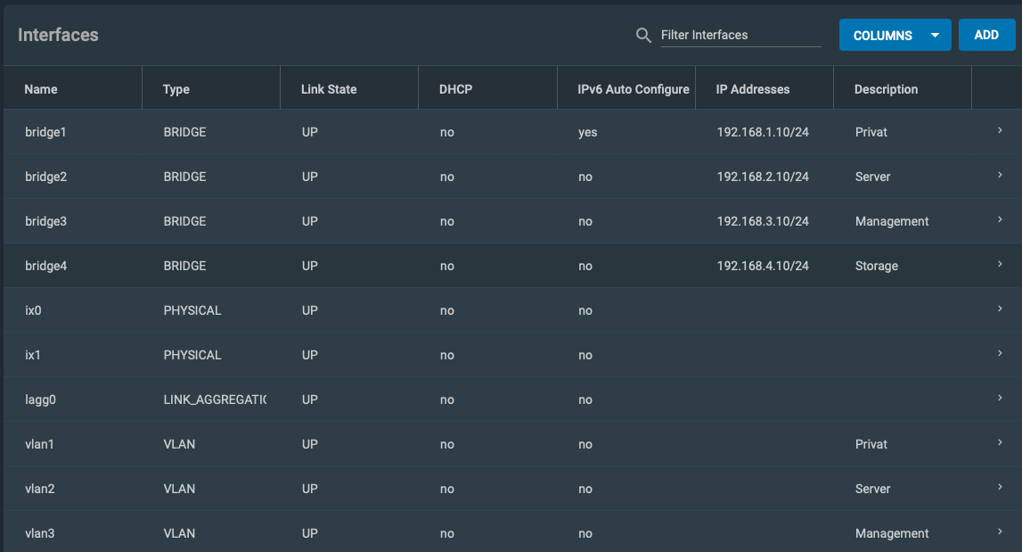

Patrick M. Hausen
Nov 25, 2013
7,776
Glad you are making progress. Definitely looks like a bug. Works - and always did - in my machine :wink:
Make sure to move all IP configuration to the bridge interfaces like in my screenshot.
