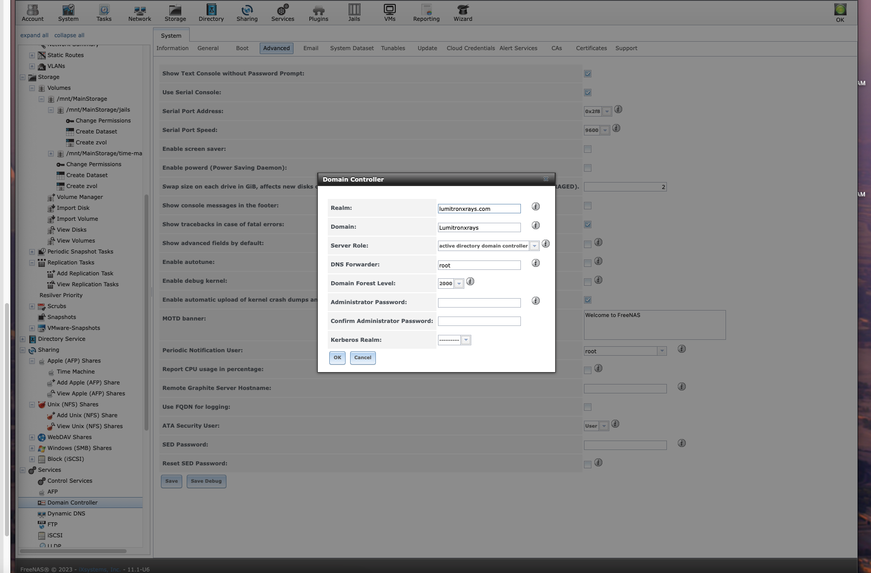

Ok, so just got hired at this small company. Have a share server with old TrueNAS 6. something version. For some reason when I log into the GUI I see they didn't have a domain included which blew me off (maybe im slow). But, some how a domain just appeared and now I can't delete to reconnect. Any thoughts or what exact info you need to answer what my issue more clearly???

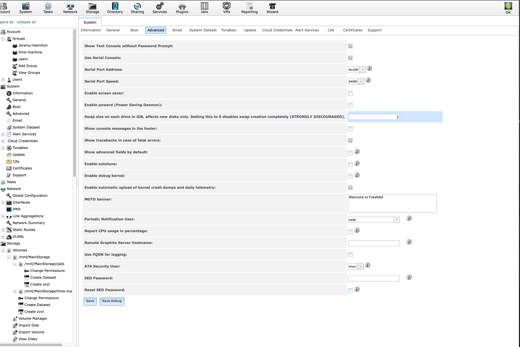

The build I have is FreeNas-11.1-U6.... When I navigate to Services and click on Domain Controller I see that I have a Realm now which was not there since I have been at this site. Again, they only utilize this for storage not sure why they went this route but here we are. I can ping my server but I am unable to connect to the share. I am thinking it has something to do with the DC and I am not sure how to delete this. I even tried WorkGroup and it won't let me save it.

Well, it's a completely different story if you're running 11.x...

Nvm I figured it out :)... With a few commands and deleting the directory and re adding it seems like it solved the issue.
anodos
Sambassador
Mar 6, 2014
9,553
