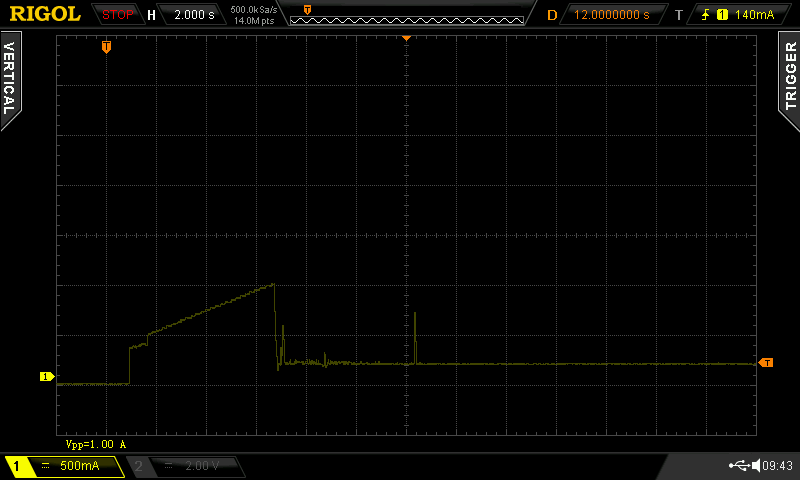

My current clamp came in yesterday, so I checked a few drives with it this morning.
Here's a trace from Seagate Barracuda ST2000DM001, 7200 rpm 2 TB:
Here's one from a WD Green WD20EARX-008FB0 2 TB
and here's one from a WD Red WD30EFRX-68EUZN0 3TB

Nice, but there's a problem: the values are too low.
It's the +12 V current or the total current?
Are you sure the probe is correctly calibrated? (checked with a known continuous current load?)
Are you sure you haven't done any mistake in setting the probe att ratio in the scope? (seems like an error of roughly a factor of 2)
Wizened Sage
11,940
That is only the +12V current. I have not checked it against a known load, largely because I don't have one. The scope is set to a 10x probe, which should be correct--this unit was set to 1 mV / 10 mA.
