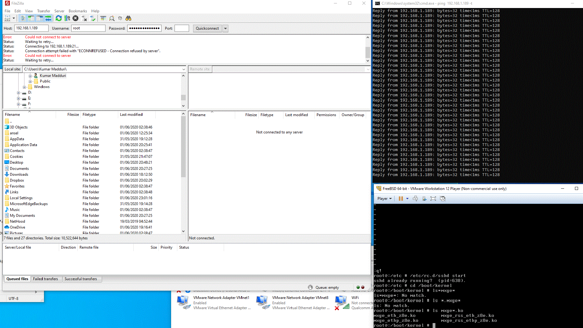

I could succesfully set up a VM on my Windows PC.
I can also see the required FreeBSD 11.3 missing mxge Kernel files in the Virtual Machine as i used VMWare Workstation 12.0 and installed FreeBSD.
However i am not able to transfer the files via Filezilla ? or any other method is much appreciated ??

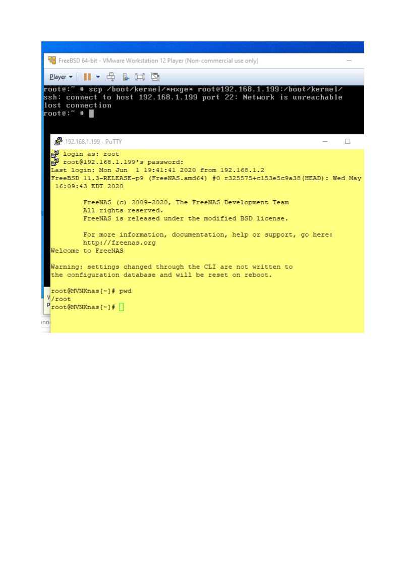

From the VM, try scp to your FreeNAS. scp /boot/kernel/*mxge* root@<your FreeNAS IP>:/boot/kernel
kumarmvnk
May 1, 2020
50
Sam
It says Network not reacheable. However i can putty it and login which is in yellow
Samuel Tai
Apr 24, 2020
5,399
Are you using NAT or bridge mode on the VM?
kumarmvnk
May 1, 2020
50
NAT
Samuel Tai
Apr 24, 2020
5,399
That's the problem. Shut down the VM, and switch to bridge mode. You should be able to reach your FreeNAS server then.

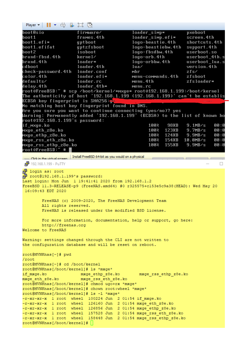

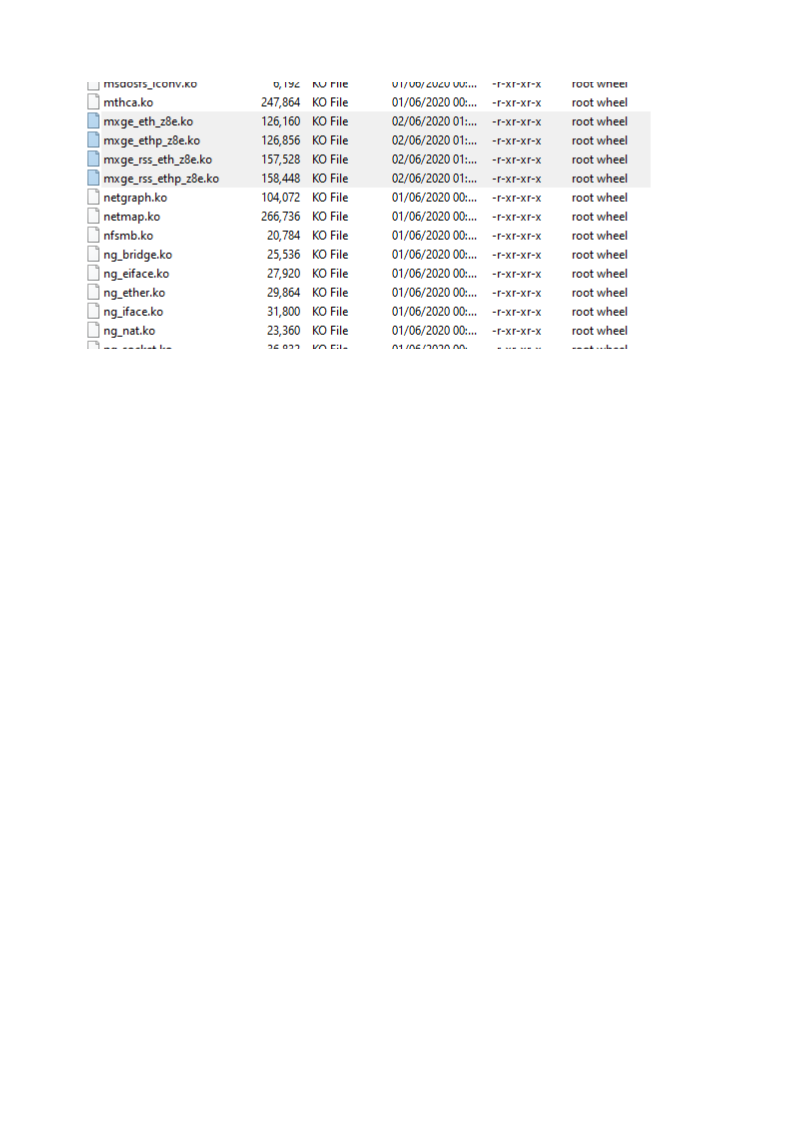

the Bridge did not work ..wondering that the install did not go right as i was unable to even ping the freenas !!
I had identified the issue i did nto use DHCP and network defaulted to NAT again , so i re-installed a fresh FreeBSD 11.3 and just used your commands.
Its copied with no issues. I am also attaching the snaps for any other Newbie's like me can just follow what you have detailed me thanking you Samuel. Big step for me on this...
After Reboot ..still the 10G lan Card does not show
I check the permissions its just like others ...again pic attached
I also had the Loder.conf & tunables as
if_mxge_load="YES"
mxge_ethp_z8e_load="YES"
mxge_eth_z8e_load="YES"
mxge_rss_ethp_z8e_load="YES"
mxge_rss_eth_z8e_load="YES"
Now wonder what ??
