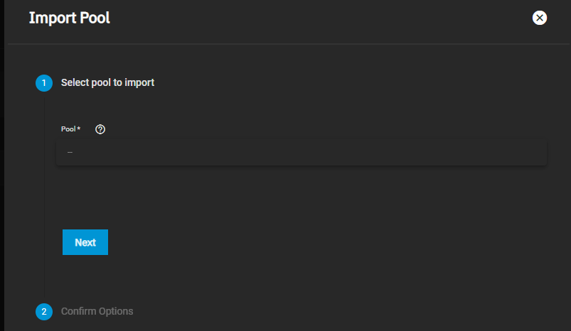

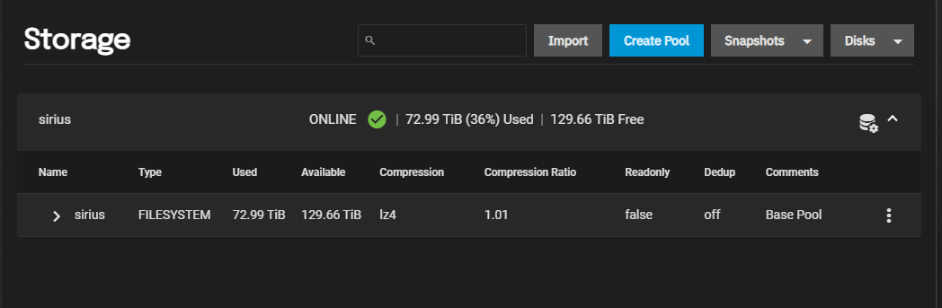

I then ran zpool list to make sure it showed up (it did). Then I went into the UI, saw that it didn't show up, so i tried to go to "import pool" but nothing shows up there either.
Here's all I see in the UI:
and import:
Update: so i tried
zpool export transcode
and this remove the pool even from zpool list. I then went and refreshed the UI, and was able to import it, now it shows up in the GUI. thanks @danb35 looks like doing things via the CLI only gets you 95% of the way there.

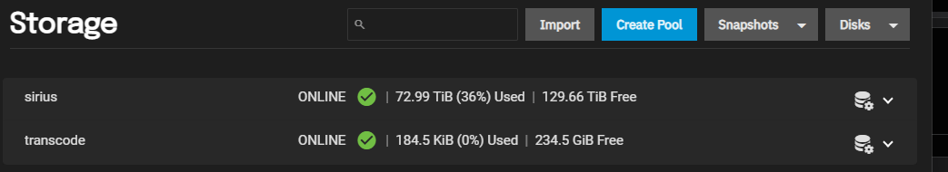

this is true, however the UI never registered it. exporting it and then reporting via UI got it to show up:
I'll chalk this up to a UI bug or something =)
15,504
That's to be expected--the UI only knows about what's in its database. It should be good from here on out, though.
