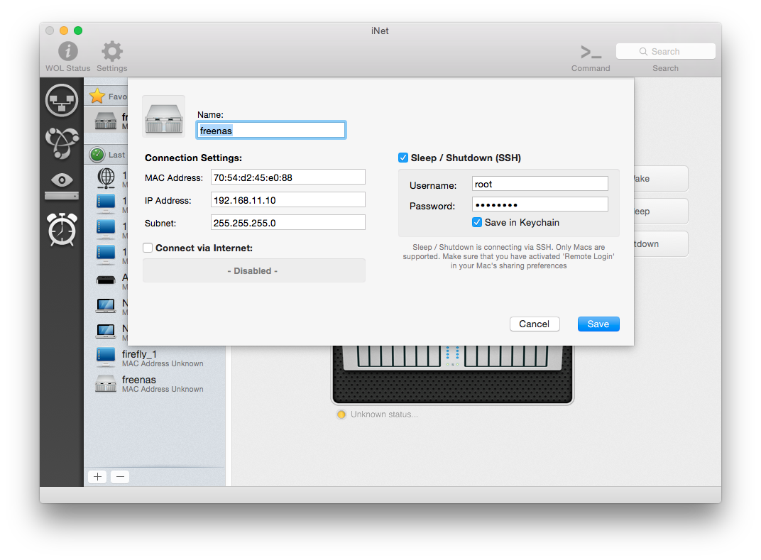

the Intel S1200kp board supports WoL and it's enabled in the BIOS (Wake on LAN from S4/S5 -> Power On - Normal Boot). WoL worked until some update in the past, when they had general problems with the WoL function. But I just set my FreeNAS completely new up (version 9.3).
I use the OS X application iNet for the Wake on LAN feature, in the future I want to boot the FreeNAS automatically when I switch on the Mac.

WoL is not an officially supported feature of FreeNAS. If it works, that is just a magical optional extra that may also stop working again at any time. :)
