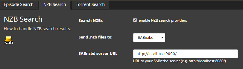

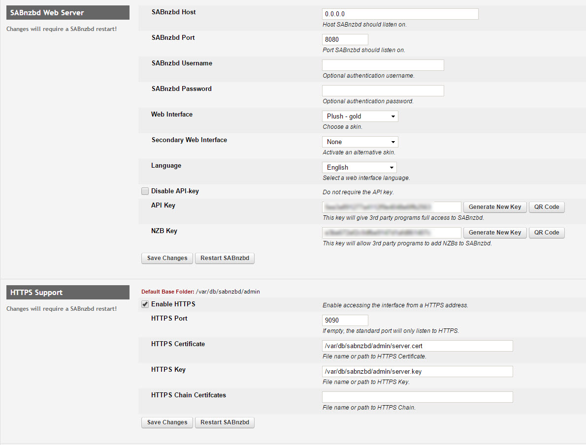

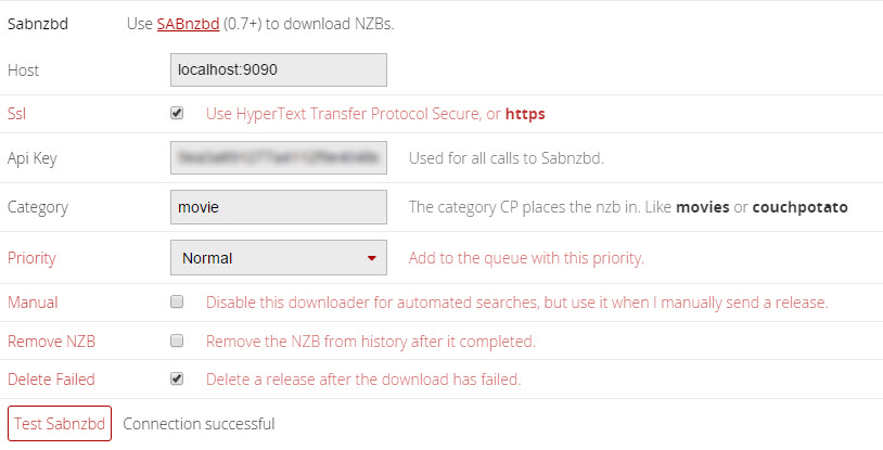

I think it's working now. Could you confirm my settings based on the images below
