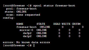

I think I just want to read that he is using them in mirror mode or something like that.
Where can I put that zpool status freenas-boot thing?

You can get to it several ways. Since you're in the webGUI, the easiest thing for you, would be to pick the shell option on the far left side. When you're done, type exit

No.
mirror-0 is the first mirror for a given volume.
So, your boot pool is comprised of a mirror, containing two devices. (da0 and da1)
hmmm should it not say mirror-1
