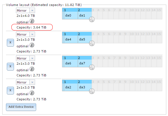

I'll try again with the help of this picture:
As you can see I have 4 mirrored sets or vdevs.
I'd like to customize the capacity of the first vdev that I pointed out in red.
I need to match the capacity of the first vdev to the others since I'm going to replace the two "temporary" 4TB drives to the smaller REDs 3TB.
If I create the pool right now as showed in the picture, I'm stuck with the two 4TB drives and I can't replace them with smaller ones.

Ah. Ok. There wasn't enough information to validate that those 8 drives are the exact 8 drives you were using. And your question seems to imply you understand the limits with vdevs, but I don't understand how you don't know how to deal with the situation.
In short, you cannot downsize a vdev after it's been created. PERIOD. You obviously know this.
That being said, what you need to do is create two vdevs that have a 4TB and 3TB mirrored. That will force the vdevs to 3TB. Later you can rearrange the 4TB to be in the same mirror to get your 4TB mirror back to full capacity. You will likely not be able to do this with the current volume manager. So you'll need to click the manual manager and create the vdevs yourself. Once done you'll be able to do what you want. ;)
Thanks for your reply :)
Sure I know I can't downsize a vdev and that's why I was asking if was possible to change capacity before creating it.
So only way to force a vdev be 3TB is to mix the drives of course.
Actually I knew that was the best way to do that but not the only. I was hoping to find a different approach (I'm not a ZFS expert) but yes in the end the final result would be the same.
Thanks again. :)
