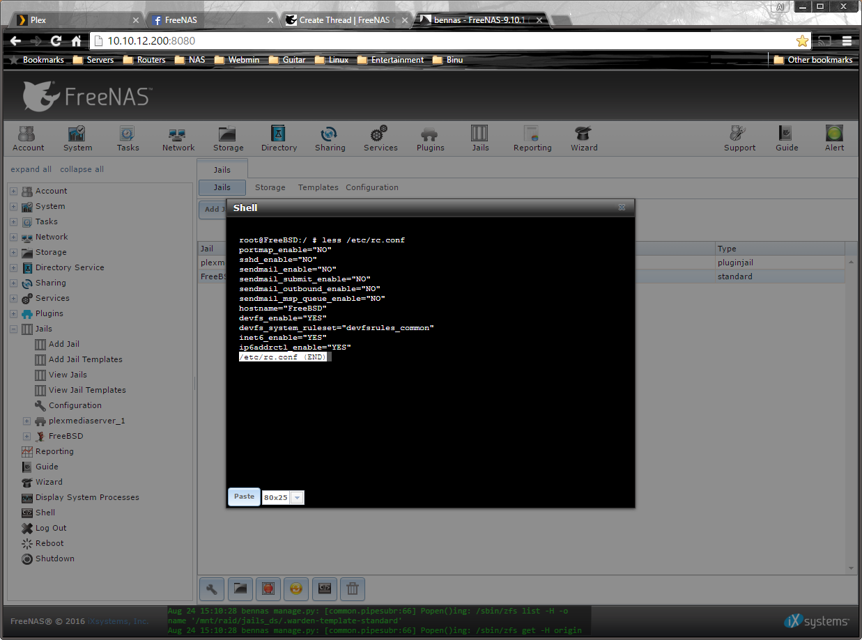

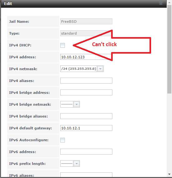

I'm unable to check the DHCP option on my jails and would like to change the configuration within the jail to obtain the IP from my DHCP server.

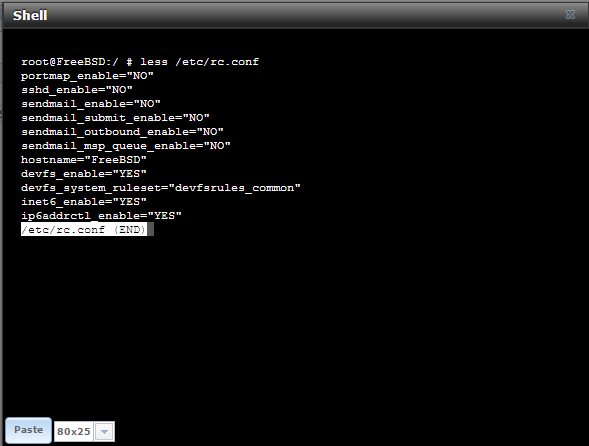

Searching FreeBSD docs it said it is configured in /etc/rc.conf, but the jail I've created with a Static IP has no IP information in it. Is this different in FreeNAS?

Found "one" solution for my problem:
- With IPv4 DHCP disabled in Jail -> Configuration
- Create the jail typing the word "DHCP"as IPv4 address. That will enable the check mark for IPv4 DHCP and I don't need to change the jail configuration manually ...
