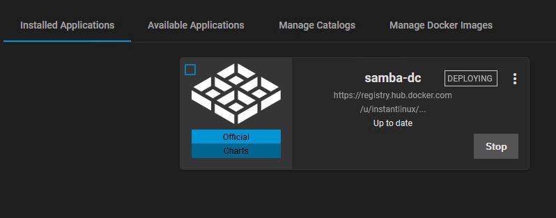

How to add some another docker app?
Jan 24, 2022
9
Every my try end up with stucking with "Deploying" forever

Try these settings:
appname samba-dc or without the -
repository instantlinux/samba-dc

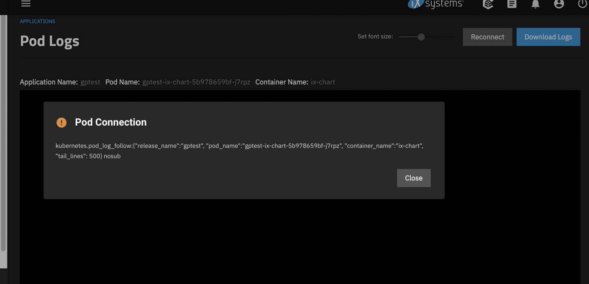

dmi3000
Feb 3, 2023
Application events are just a list of what the system has attached to your App.
It only state what has failed and sometimes (if it is relating to the system attaching things to the container) what attachment order was crashing.
It does not tell you what inside the container itself is crashing/breaking.
You would need to check the container logs themselves for that.
Trying to check the logs leads to this message
