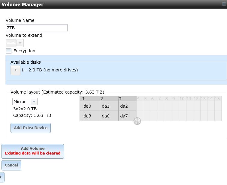

"Striped mirror" and "Mirrored stripe" are both equally not-real-good ZFS terminology.
What you want are multiple vdevs, where the vdevs are (probably two-way) mirrors. That's the layout you show in the image above, and that's going to be good for IOPS.

So to confirm, i have 3 Vdevs above:
Vdev1: da0 + da3 (mirror)
Vdev2: da1 + da6 (mirror)
Vdev3: da2 + da7 (mirror)
Shouldnt I have 6TB of storage?

My guess is that configuration pictured is 2 vdevs (each with a 3 way mirror).

That picture shows three-way mirror and the projected size confirms as much (3.63TiB). You can create the zpool by adding a mirror then click "add extra device" add mirror, then click "add extra device" add mirror; Then click add volume. Check the zpool layout with zpool status command to make sure its what you want.

So this is a single Vdev which is mirrored (and striped also?)

No, it is a single zpool, which consists of three mirrored vdevs. Each row is a single vdev consisting of two mirrored drives.
You should really go back and reread the vdev/pool/dataset guide. Each pair of mirrors is a vdev, for a total of 3 vdevs in your pool.
