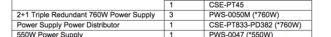

I have the impression that it's really the power distribution unit that defines what cable runs are present. I am further confused because there are two different models that appear to apply here. My case manual refers to a CSE-PT833-PD382 that goes with the 760 watt option that I didn't get.
The SC833T-R760 data sheet refers to a PDB-PT933-8824.
I have not yet found anything that describes these devices and their differences, and the pictures I've found have the cables cinched up in a bundle so I can't get a count. Neither are available on the Supermicro eStore nor can I find data sheets for them. I am way open to suggestions here.

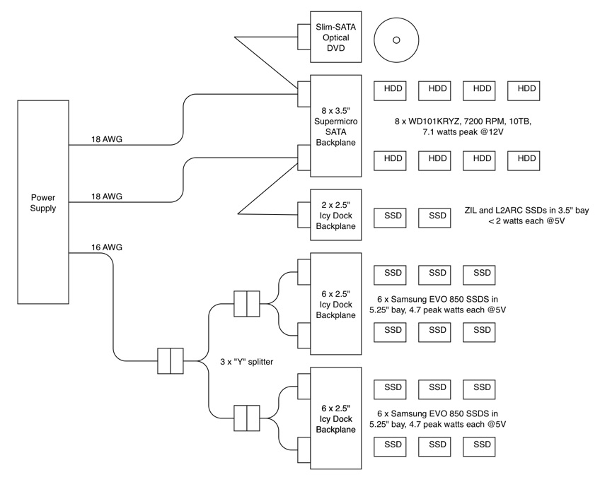

A picture is worth a thousand words. This is what I'm considering doing:

I don't see why that would be a problem. I also find it odd the system didn't come pre-wired.
Do you need both molex connectors on the backplane though? Typically that's only necessary for dual-power supplies. Check your manual, one molex connector per backplane should be sufficient and typically you'll have two indicated for dual power supplies.
Ideally, you wouldn't have two consecutive Y-cables. You should put splitters on all 3 runs (provided they are actually separate 12V/5V lines).
Given you say there is a different AWG it indicates that some lines may not carry as much current as other ones.

The reason it didn't come prewired for this configuration is because I went off the Supermicro reservation when I started using Icy Dock backplanes. Supermicro offers an optional 8 x 2.5" cage that takes up both 5.25" bays, but Icy Dock lets me fit 12 in the same space; 16 if I want to use their 8-slot cages.
Your comment about only needing one power connector per backplane is new to me. I'll consult the manuals. If true, I'll redraw the routing because this becomes a bit simpler and would eliminate the cascaded splitters.

It appears that both power connectors must be used on all the backplanes. That's implied in the case manual, and explicitly stated in the manual for the optional 2.5" cage. The Icy Dock manual also shows pictures with both 4-pin Molex connectors plugged into separate power cables. I calculated that 12 2TB EVO 850s would peak at 11.28 amps at 5V. That's pushing it for 18 AWG wire, which is probably why they double-up.
In the redundant power supplies from Supermicro that I've seen, a power distribution unit allows multiple supplies to feed a single wiring harness rather than having cables from each supply run directly to devices.
