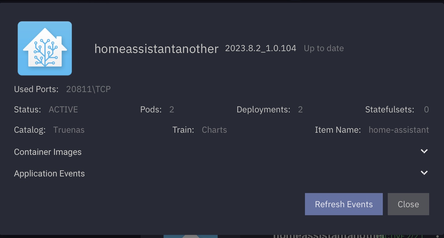

Black_Duck
Oct 8, 2022
61
Ive postet all of the four logs, that i can view in the webinterface.
What log do you mean?
The logs you have posted are the Container Logs within the pods.
But you have the situation of "Deploying (1/2)" which means the home assistant pod is not up yet.
Need to find out why it's stuck deploying the pod (i.e why Kubernetes has not completed deploying the pod)
  • on the Apps page ("Installed Applications"), click on the "Home Assistant" box (around the word "Up to Date")
  • You should get a window pop up looking something like this:
  • tap the "Application Events" and check if there are any errors in the log.
  • tap on "Container Images" to see what is deployed and what is not.
MrJoki007
Jul 15, 2018
45
  • View attachment 69551
Oh ok, didnt know this page:
Application Events
2023-08-21 19:47:22
Back-off pulling image "homeassistant/home-assistant:2023.8.3"
2023-08-21 19:47:22
Failed to pull image "homeassistant/home-assistant:2023.8.3": rpc error: code = Unknown desc = context deadline exceeded
Container Images
homeassistant/home-assistant:2023.8.3 Up to date
postgres:13.1 Up to date
