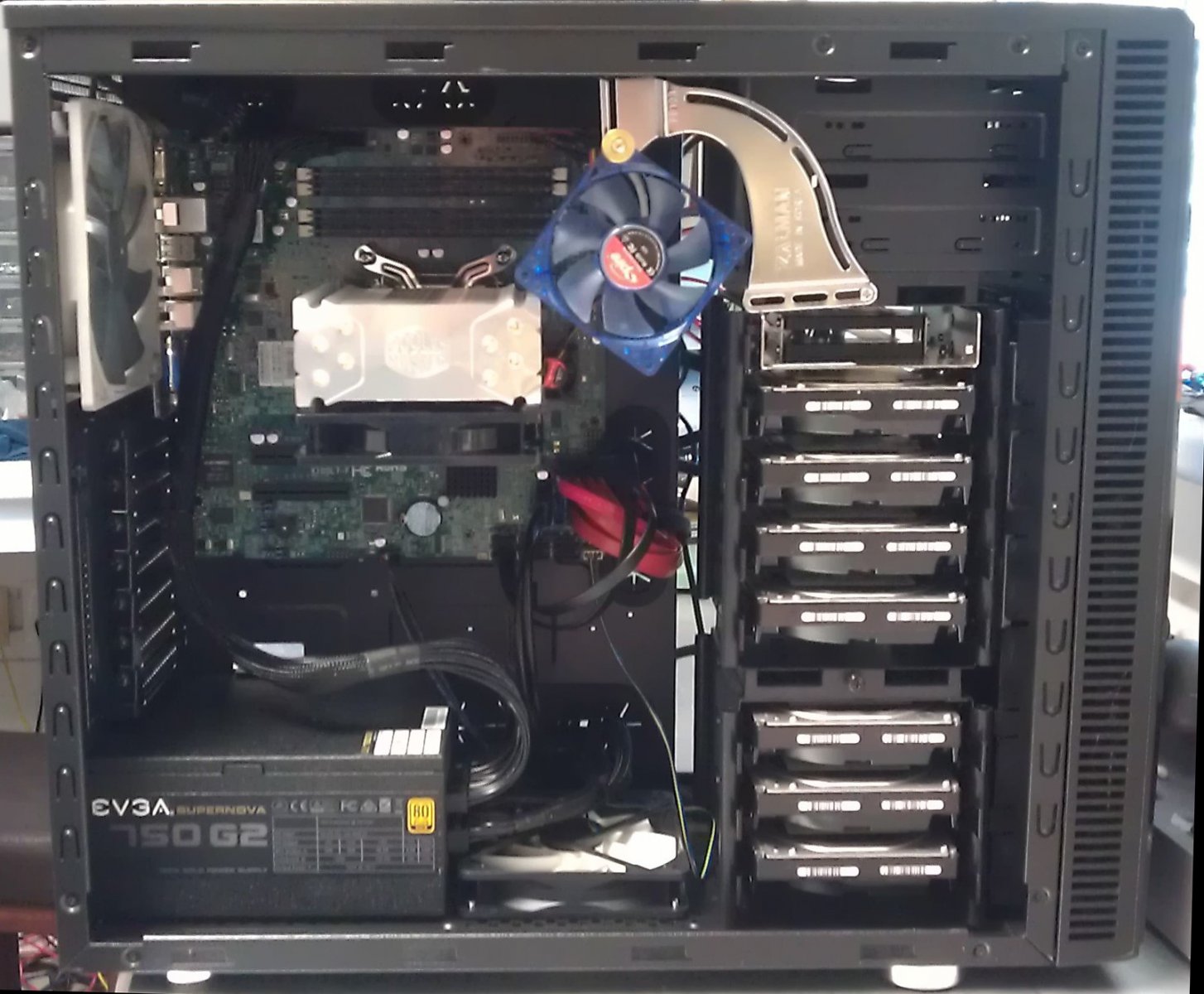

I replaced the rear fan supplied with the Fractal R4. Here is my list:
  • Cooler Master Hyper 212 EVO : CPU
  • Noctua NF-P14S redux-1200 (140mm) : top case front
  • Fractal (140mm) (supplied w/case) : bottom case front
  • Noctua NF-P14S redux-1200 (140mm) : case rear
  • ARCTIC F12 PWM (120mm) : case bottom
  • Antec (?) (80mm) : Zalman FB123 bracket
  • Evercool (30mm @ 7V) : LSI heat sink

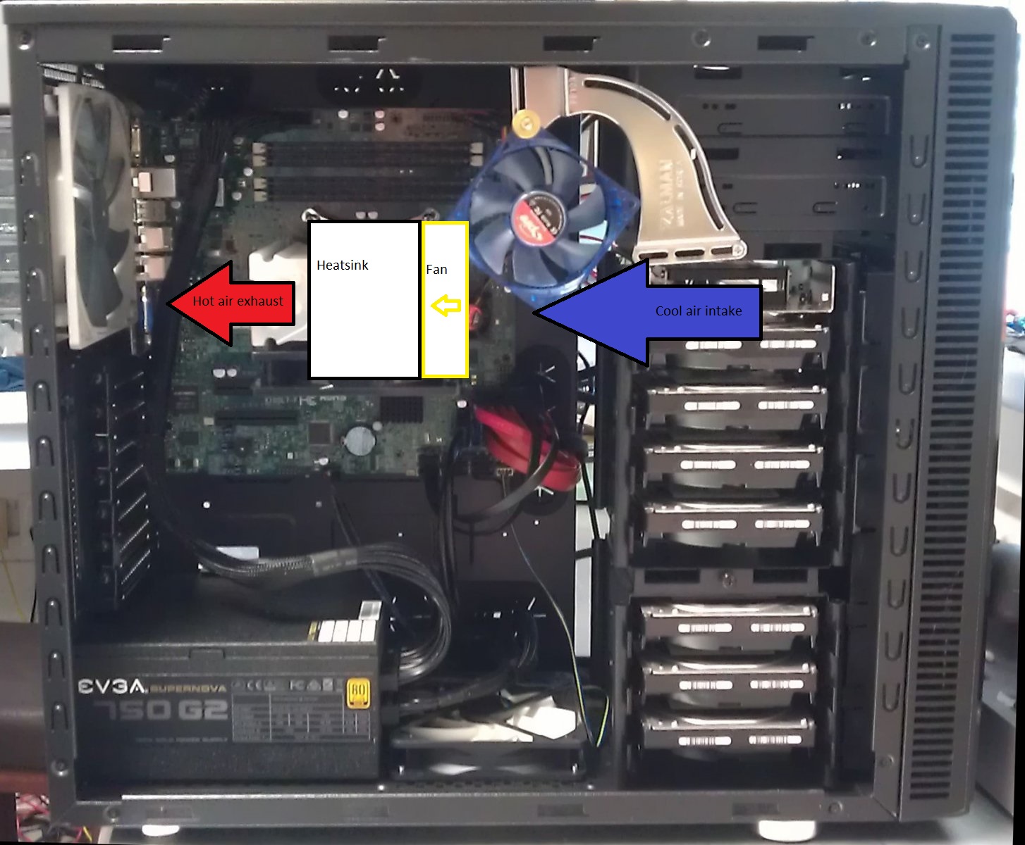

Why isnt the CPU cooler oriented so that air blows all the way through the case? Excuse the crud mspaint skills

Darren Myers said:
Why isnt the CPU cooler oriented so that air blows all the way through the case? Excuse the crud mspaint skills.
Because the memory modules preclude it from being mounted in that orientation. The current orientation isn't a problem as far as cooling goes; the CPU never breaks 40C at its busiest and runs at 29C most of the time.
