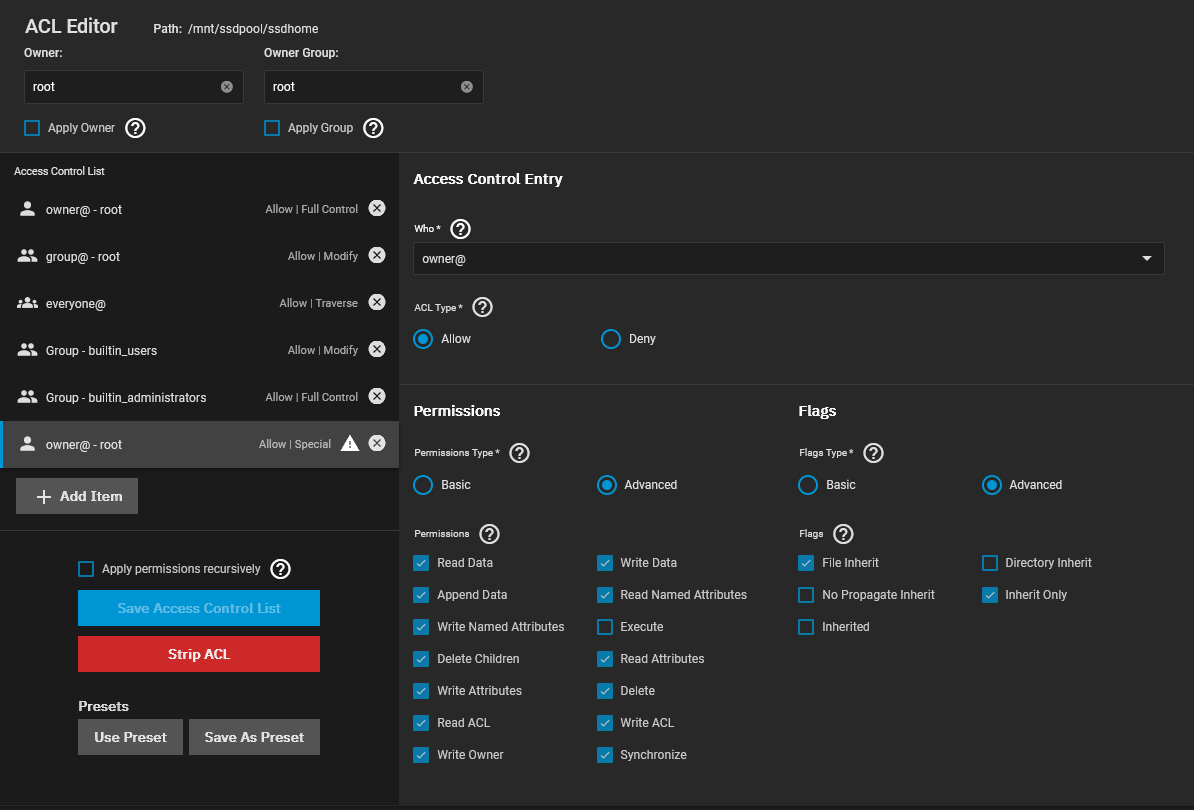

Here's what I did. First, I set the the acltype at the dataset config level:
  1. Select Datasets from the left-hand navigation pane
  2. Select the target dataset
  3. Select Edit in the Details pane
  4. In the Edit Dataset pane, select Advanced Options
  5. Set ACL Type to SMB/NFSv4
  6. Set ACL Mode to Discard. Note: I'm not 100% sure about this. It appears to be working, but I semi-guessed on this one
  7. Save
Now we should be back at the main Datasets screen. Now we can actually edit the ACL per the suggestion above. First step is to set an NFS4 preset:
  1. Select Edit from the Permissions pane
  2. Check the Apply permissions recursively box
  3. Click on Use Presets
  4. Use NFS4_HOME or NFS4_DOMAIN_HOME. Notes: I'm not sure what the difference between these two presets is. I tried with both, and I couldn't see any obvious difference. Other presets may be more suitable for your use-case. But for me, it is a network-shared home directory.
  5. Click Save Access Control List
This puts me back in the main Datasets screen. Now we need to go in and actually tweak the preset ACL:
  1. Click on Edit in the Permissions pane
  2. I first modified the owner@ - root ACE: I changed the Flags Type to Advanced, then checked the Directory Inherit and Inherit Only boxes. See screenshot below.
  3. Then I created a new ACE - it is nearly the same as the one we just modified, except: Flags Type is Advanced, with File Inherit and Inherit Only selected; Permissions Type is also Advanced and all permissions except Execute are selected. See screenshot below.
  4. Click Save Access Control List

Here's the screen of the default ACE being modified:
And here's the screen of the new ACE:
Note that the TrueNAS GUI is flagging it as an error (triangle with the exclamation point). But my GUI also exhibits the same behavior discussed here, Is ACL editor bugged in 22.12.2?. So I'm not sure if this is truly an error, or a display issue. If it is indeed truly an error, I'm hoping someone can give me a hint as to what is wrong!
Anyway, I hope this is helpful. Note that I'm not 100% sure it's truly the right way to do what I want, but it seems to be working correctly. I'll update this thread if I find any issues.
