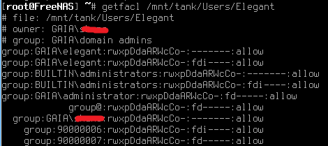

Hi guys,
When creating a Home Directory through AD I've always noticed that the ACE for the end-user is marked as a group NOT a user which causes a conflict with programs in Linux. I believe this to be a bug but the question would be whether this is FreeNAS or Samba that the bug lies with. You can see an example of this in the attachment group:GAIA\elegant is not a group. Anyone have any ideas? I seem to recall this issue being mentioned before somewhere (not necessarily here) but can't find it. Thanks!
This is with FreeNAS 9.10.2.

I actually have nfs4:mode=simple already, this is also the only parameter I have added to that specific share. My screenshot is a bit out of date (extra ACEs) but I attempted this on a new share a couple days ago and had the same result. Something is finding the entry but is not bothering to determine if it is a user or group and just chooses group by default(?).
Are you able to reproduce this as well? I simply make a fake user in AD, give it a home directory on this 'Test' share and getfacl the user's home directory.

I think this is a side-effect of how the RID idmap backend works / interacts with ZFSACL. For instance, if you type id "DOMAIN\Bob" the output will be uid=21112(DOMAIN\Bob) groups=21112(DOMAIN\Bob).
<speculation>There's probably not a quick & easy way to determine whether a SID is for a user or a group, and so the backend just shotgun-blasts UIDS/GIDS based on the RID component of the SID & the idmap range specified in the idmap configuration lines of the smb.conf file </speculation>
