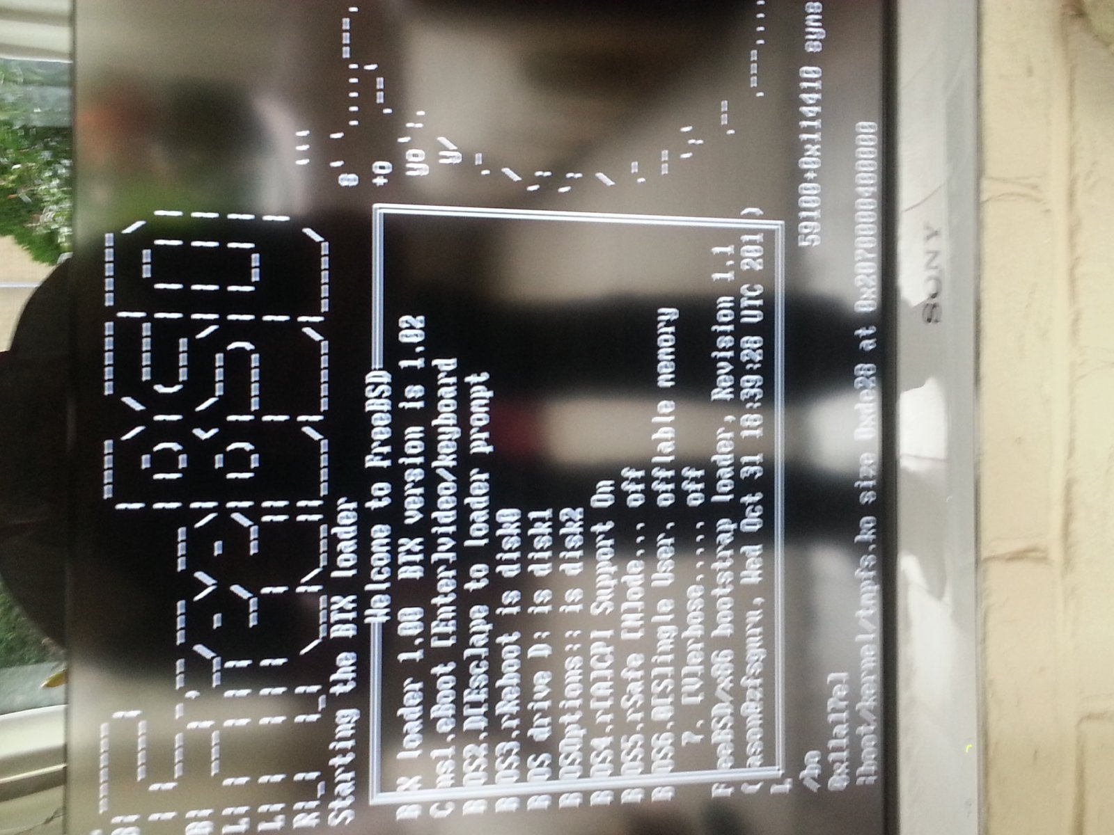

ikkenjij36
Jun 9, 2013
59
this how it looks like when it's supposed to boot again

Dusan
Jan 29, 2013
1,165
ikkenjij36, looking at your "screenshot" -- that does not look like FreeNAS boot sequence, it actually mentions ZFS guru. Are you sure you are trying to install FreeNAS?
