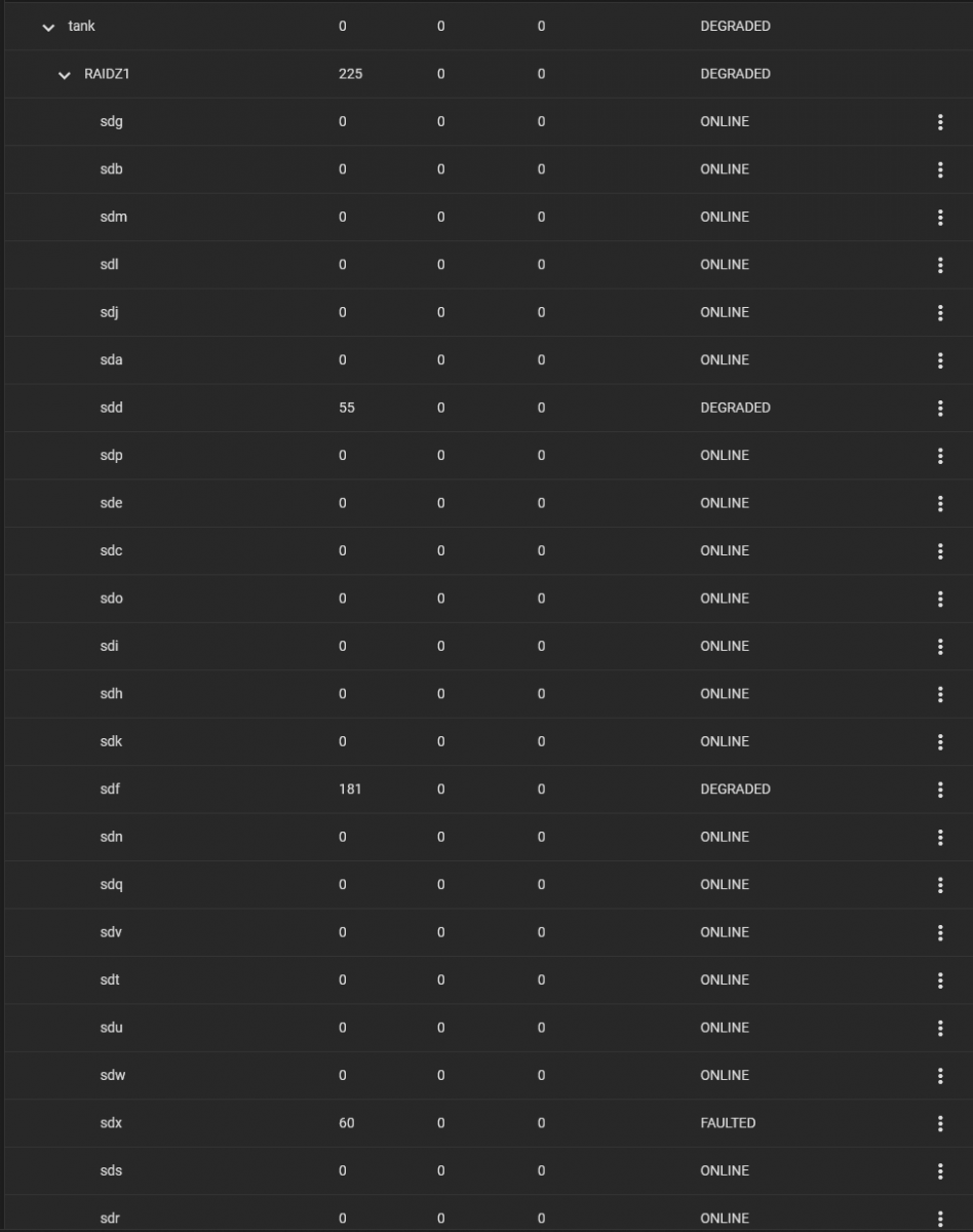

Just recently moved all my data from a storage server I have running Windows storage pool on HW raid5.
This is from a datacenter and got a server with 24 x 10TB drives, and my config was using raidz1. Now after a few days of moving files and completed moving all the files Ive redirected all the services that need to read this data. After about less than a week, this is now my pool status.
What should I do? 2 drives are "Degraded" and another is "FAULTED". Altho the data is still intact, I just dunno what to do with this. I still have the old window server tho, so data can be moved again, but its gonna take days again to move files and redo configuration on all the other services that read the data.
Running Truenas Scale 22.02.0.1 right now.

1st - Z1 for that many 10TB drives is insane. You should be using multiple vdevs of 12 wide at most in Z2 minimum. So as a minimum 2 vdevs Z2 12 wide would be a start. Resilver time will likley be horrible. Just cos you can do something doesn't make it a good idea
Look at the smart stats for sdx - can you see why its faulted? Replace that drive and hope you can resilver. However make a backup first!!!!!!!
Once (and if) sdx is replaced sucessfully you will probably need to do the same for sdf and sdd, which means you have to resilver 3 times.
BTW how full is the pool? If its fairly empty then that will make the resilver go quicker.
Question - Are you running regular SMART tests
Honestly I would go back to the working Windows Server, trash this pool, replace the three disks and the rebuild the pool in a sensible manner then recopy the data and redo the configurations
9,700
Big danger there... I hope you have a backup for anything you're not wanting to lose on that pool.
You'll need to start by replacing the faulted drive, then deal with the other two, but there's some likelihood you'll have some corrupt/impacted files unable to be recovered with that situation.

I might have not highlighted this quite well. This is a test for us, the data on here are all backed up on the previous server where data came from and another offsite backup. We only are moving stuff to try out Scale and probably gonna move into scale + truecommand and go clustered storage with glusterf once that goes out of beta. Data compose like 10% of our total data which our services can work without, altho kinda annoying for the users to lose these parts but not a deal breaker and minor nuisance with reverting back to the old windows server.
Im just confused how this all went south really quick. All three drives just went bad real quick. I dunno if its a scale thing or just the DC gave me 3 bad drives from the start and should have ran test on them.
Probably yeah we might just reconfigure the whole system for better redundancy.
Also, asking the question for purposes of knowing what to do in case this happens when we fully commit to truenas for everything production.
Anyway, I might have missed it on the documentation, but does "degraded" as status in the pool mean its still working but should be replaced soon? Conversely, is "faulted" means its dead already and should be removed asap as well? Seems data is still working tho, so maybe it can still be fixed by replacing them one by one?

Replace one by one as you only have 1 parity (and that ain't working)
Most here say you should stress test any new drive before putting it into service.
Personally, with any HDD (I haven't figured out what to do with SSD's yet) I do the following:
1. Open a tmux / screen session with a window for each disk
2. Run a long smart test - look at the results
3. Run badblocks destructively (take a bit less than a week on a 10TB) - look at the results
4. Run a long smart test - look at the results
If the drive passes that, then it should be good.
Degraded is still working (with errors) - but has serious issues. Faulted is ejected from the array. You are now running with no parity and ZFS has no way of fixing bit rot - although that is the least of your issues at this point. Given that you also have two degraded disks as @sretalla says you may have some corruption already and resilvering that much disk space with no parity three times is mathematically quite likley to throw an error and corrupt more data. Effectively you are running Raid 0 with two dodgy disks at this point (sort of). If any disk fails you can say goodbye to the pool
9,700
Perhaps if you share more details on your hardware and specifically how you have attached those 24 drives, we might be able to see something that would explain the errors.
Can you also have a look (and share with us if you like) the output from dmesg
9,700
In case you were unaware, you're currently running 24 disks with the IOPS of only one... so 24 disks giving you something like 100-300 IOPS.
As soon as one disk fails, you have no more redundancy, so that's 23 disks running as RAID0 (but still the IOPS of one disk) until resilvering can finish.
Anyway, to recommend what you should be doing (without really understanding your workload at all), at least you should change to 2 x 12 disks RAIDZ2, which will mean you can lose at least one disk in each VDEV and still have redundancy during resilver.
Yes, that means you have 3 additional disks capacity lost to parity, but your chances of a 2 disk failure killing your pool goes from 100% to 0% and you double your pool's IOPS at the same time.
Errors could be a bad cable. Anyway, with en excessively large vdev (10-12 is the recommended practical maximal) and an unsecure geometry, things are expected to go south VERY quickly.
Correct, except that it's more like "degraded" should be fixed asap while "faulted" should have been fixed yesterday (if you got any early warning…).
If it's just test data that is already backed up elesewhere, delete the pool, test the drives and recreate a safer pool.

Thanks for the tips guys. yeah we'll actually just trash this pool and start over after DC replaces drives.
Would appreciate your help and opinion on the resetup tho.
On the initial testing on the drives. Altho I dont think we got a week to test all the disk before using them because assuming disk is bad and DC replaces bad drives means thats another week of testing new drives. Maybe there is a way to test them all quicker and we can follow also your recommendation with 2 x vdev on RaidZ2?
Initially also we didnt want to waste a lot of disks since we already have an off-site mirror of the files and, again its a test of the truenas scale system and it's feature sets and not really about redundancy as of the moment. Also we expect to move into clustered storage having 2 x replicated data, so that would use up a lot more of the usable space.
Assuming our data would span about 5 storage servers all having 24 x 10TB drives and 2 x 1TB NVMe drives as cache drives, what should be the recommended configuration of the pool? We prefer cost savings in terms of more free space rather than having bulletproof resilience in redundancy, since we already are mirroring this to an off site backup and actually planning on doing a gdrive copy of the whole data. Data is about 500TB and growing and we might be adding more storage servers as needed.

Here's the dmesg if youre interested in checking @sretalla
[161534.286976] sd 0:0:73:0: [sdx] tag#832 FAILED Result: hostbyte=DID_OK driverbyte=DRIVER_SENSE cmd_age=13s
[161534.298357] sd 0:0:73:0: [sdx] tag#832 Sense Key : Medium Error [current] [descriptor]
[161534.307351] sd 0:0:73:0: [sdx] tag#832 Add. Sense: Unrecovered read error
[161534.315135] sd 0:0:73:0: [sdx] tag#832 CDB: Read(16) 88 00 00 00 00 03 0d e2 d3 40 00 00 02 00 00 00
[161534.325304] blk_update_request: critical medium error, dev sdx, sector 13117871120 op 0x0:(READ) flags 0x4700 phys_seg 28 prio class 0
[161534.339530] zio pool=tank vdev=/dev/disk/by-partuuid/f678be3b-bb5d-44d2-8ecd-04c4378b5286 error=61 type=1 offset=6714202357760 size=352256 flags=40080c80
[310738.427283] sd 0:0:53:0: [sdd] tag#195 FAILED Result: hostbyte=DID_OK driverbyte=DRIVER_SENSE cmd_age=13s
[310738.438717] sd 0:0:53:0: [sdd] tag#195 Sense Key : Medium Error [current] [descriptor]
[310738.447268] sd 0:0:53:0: [sdd] tag#195 Add. Sense: Unrecovered read error
[310738.454737] sd 0:0:53:0: [sdd] tag#195 CDB: Read(16) 88 00 00 00 00 03 bd eb 00 18 00 00 02 00 00 00
[310738.464842] blk_update_request: critical medium error, dev sdd, sector 16071197128 op 0x0:(READ) flags 0x4700 phys_seg 7 prio class 0
[310740.193421] zio pool=tank vdev=/dev/disk/by-partuuid/ed91247a-a624-4ae2-8ade-c7e937cf5a45 error=61 type=1 offset=8226305159168 size=311296 flags=40080c80
