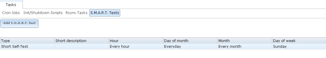

It looks like "Short Self-Test" is already enabled to occur every hour on Sunday. That sounds like a lot. Should I change it to only happen for one total hour instead of every "N (1) hour"? I attached a screenshot of the Task screen. The SMART service is enabled.
But it sounds like I need to add another task for a "Long Self-Test" which should be once a month.
By the way...I appreciate the help.
It should only be run once on a given day. Overall frequency recommendations vary from daily to weekly.
That's what I would go with. Some members run them more often.
