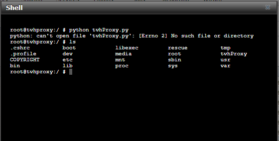

Moved on to the next step and now getting this:
root@tvhproxy:/ # python tvhProxy.py
python: can't open file 'tvhProxy.py': [Errno 2] No such file or directory

You are not in the directory of the file. Use the 'ls' command to see the files in the directory you are in.

8
gt2416
Feb 4, 2018
262
Ok so the you see the folder tvhProxy in your picture? 'cd tvhProxy' to go into the folder and then run the python command.
If you didnt know where the .py script was how did you edit it o_O ?
Also I would recommend watching a YouTube video on USING shell in a unix / linux environment, the basics are important because then you can understand what the commands actually do and you can adapt them to YOUR setup. You almost have it, just keep trying..
