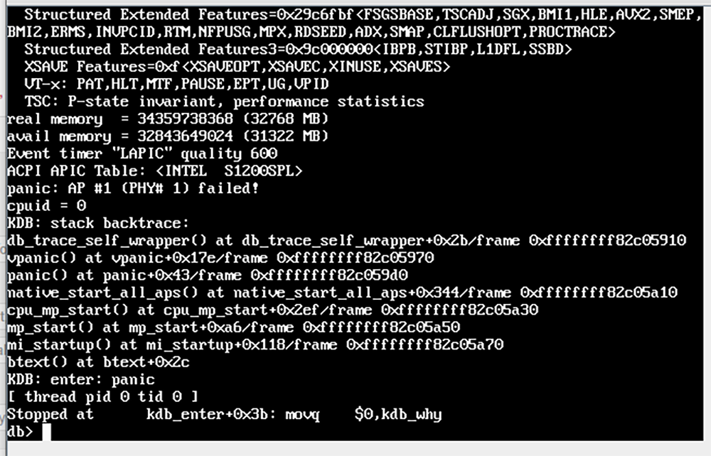

Help! The server crashed repeatedly recently!! The following error is prompted!!

It looks like your config file might be corrupt.
Try installing a fresh boot drive and you can check to see if you have config backups in your system dataset (on your data pool once you import it into the fresh install).

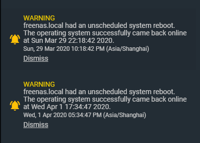

The crash happens every time you operate the web background. It seems that it hasn't happened if you don't operate the background! After the server is restarted, it is back to normal use. I am a RAID1 made by two Kingston a400 Thank you very much.
