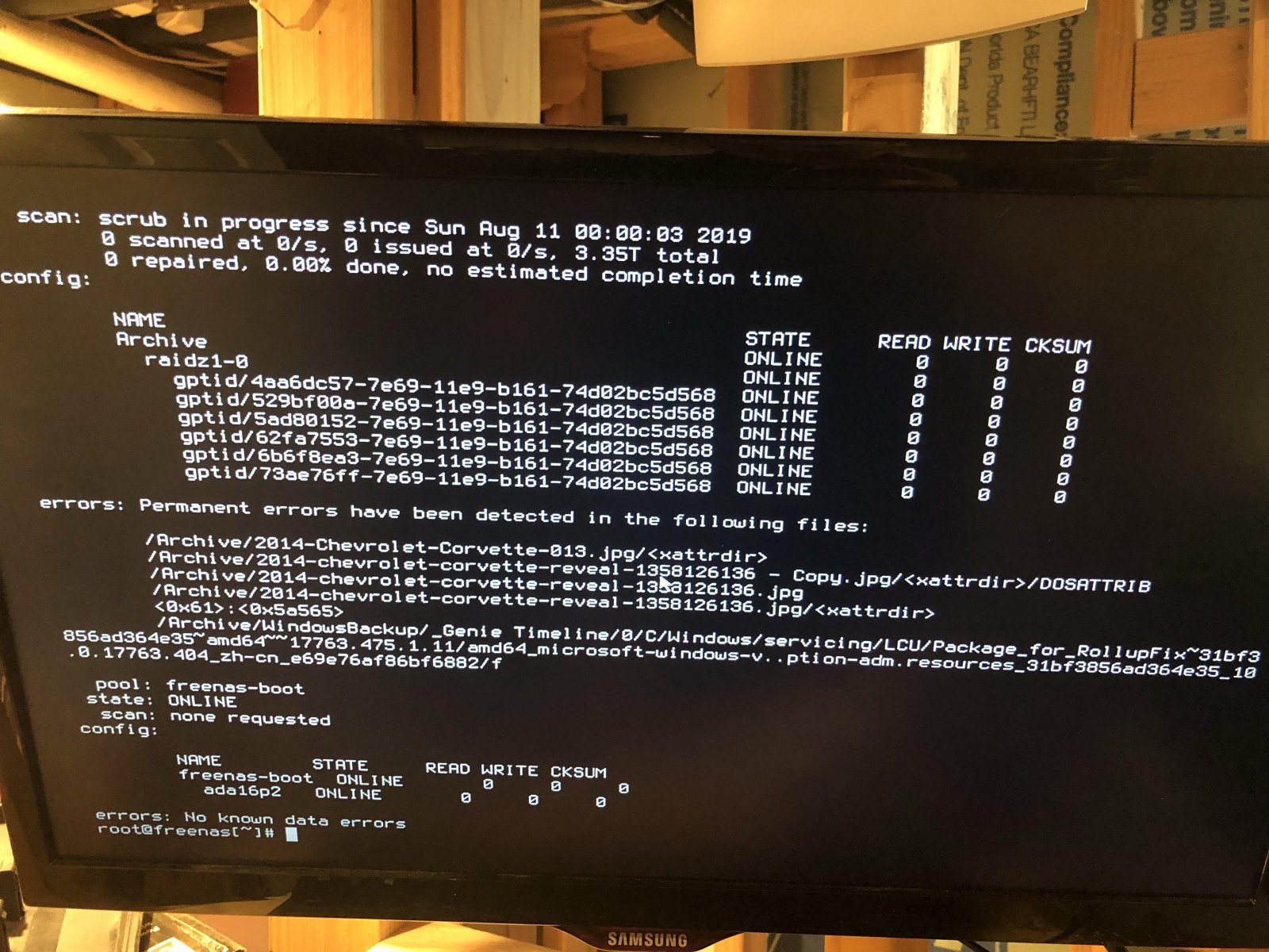

So I was able to get my zpool to import read only, but when i try to import the array normally, the same previous error occured (as above)
and when using the zpool status command, i get this message, and apparently a few of my files have errors in them, but since the array is read-only, I can't delete them. Is there a way I can just get my files off the read only array, because in the FreeNAS UI, it does not show up under pools, and I can't set up any file sharing services. I am not exactly sure how to proceed.

9,700
To be clear, importing your pool like that isn't things back to normal. You should look into using something like rsync from the CLI to get your important data backed up to something else, then rebuild your pool and restore the data.
