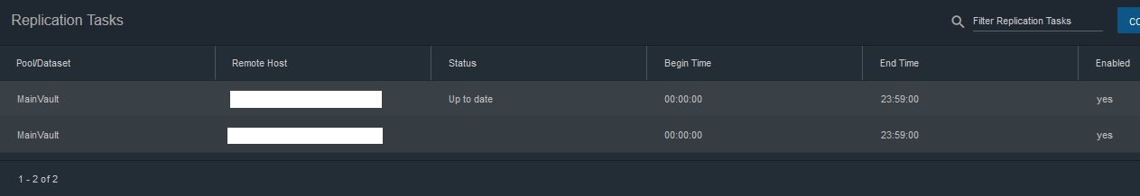

I will wait again but I have already done this. Not sure how to kick start the process. Attached is a snapshot of the replication tasks menu in the modern UI.

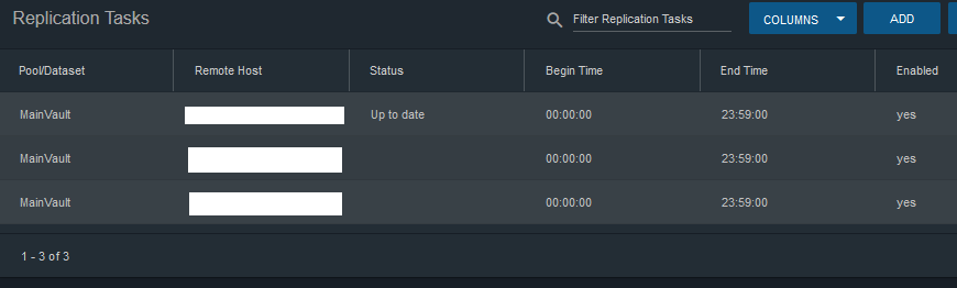

Well, i double checked this morning and still nothing I have a task setup for OffsiteA and OffsiteB but nothing happens. Is there something I’m missing? I attached a screenshot of the Replication task menu. The bottom two tasks are the offsite tasks. No errors, it just sits there.

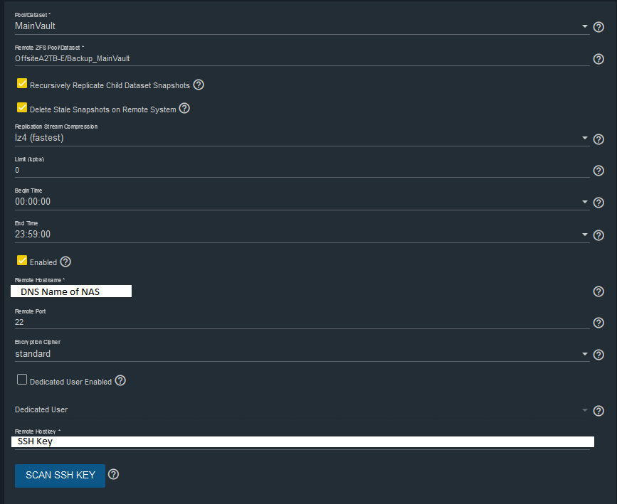

Afternoon,
Yes replication of my main pool is working just fine to the INTERNAL drive called OnsiteBackup4TB (#2 as you called it). Replication to (#3) is an internal 2TB drive named OffsiteA. Replication just sits there without any error and does not do anything. This is also the case for (#4) OffsiteB which is in a eSata conncted 2 Bay DAS case. Also I'm blanking out the DNS name of my FreeNAS box because I don't want to share any info I don't have to. All replication tasks are pointed to my FreeNAS server where the hard drives reside.

OK. Assuming that the target datasets exist, my guess is that the SSHKeys are the problem.
I had problems with this aspect when recommissioning my primary server after a motherboard change. I didn't get the copy/paste right and the desired replication of snapshots to my backup server didn't occur and I got no indication that it did not occur. This is at least part of the reason that I replied to your post.
I suggest that you retrace the keys step.
Thanks for the confirmation that the blanks are showing the same info. If I were really struggling I'd put the server's IP address in there "just in case"...
as I never tried replication to a DNS name and thus have no history on that. I assume it should be fine, but ...

The target datasets do exist. If the setup is the same, i’m not understanding why the ssh keys would come into play. I let the task populate the information itself after clicking scan ssh key. No further input was done by me. Wouldn’t I get a failure status of some kind? I got one before when the path was off or the key was incorrect. This just doesn’t seem to make any sense.
Interesting note btw, if I click scan for ssh key in the modern UI, it is missing information. I have to go into the legacy UI and scan for the key. Seems to be a bug.
That may have been the issue I experienced. I did not get any message indicating replication failure. As everything else in my config was ok I "redid" the keys, twice actually as I recall.
