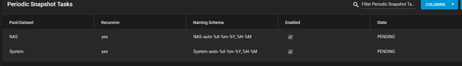

As a post-script, I see this under Tasks/Periodic Snapshot Tasks
Note where it says 'Pending'. It has always read 'Pending' since I first started TrueNAS back in April. It's supposed to run Snapshots once a week. Does 'Pending' mean it's waiting for next Sunday at midnight or does it mean it's yet to happen for the first time ever?
Thank you.
That's what it means.
When it has run successfully (completing its present task) you'll get the lime-green-ground "FINISHED" box.

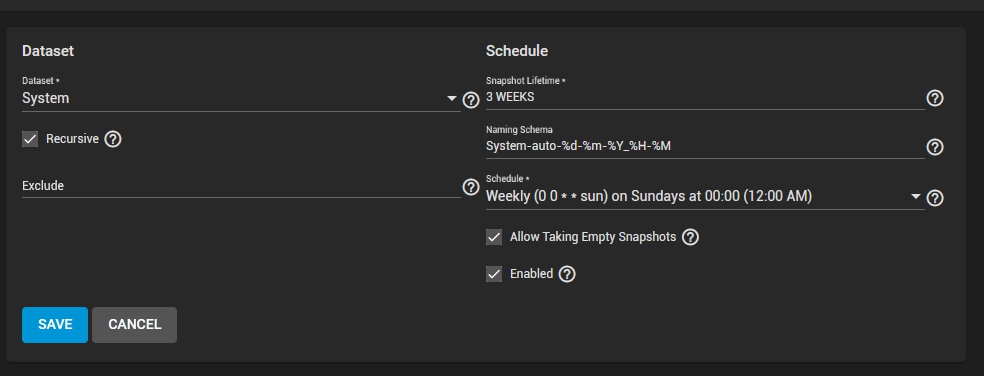

Hi
Any idea why my Tasks/Periodic Snapshot Tasks never run, just sit there month after month 'Pending'? The main view is in the image above. Here's one of them in 'Edit' view (they both look identical in edit view, by the way).
The dialogue box isn't that complicated so I can't see any opportunity for me to have done something wrong here, yet the snapshot tasks remain Pending. I am flumoxed! Thanks for your thoughts.

Did you try to force it to "run now" and seed the process? I think I always did that to check that the config was correct.

Hi
I see no "Run Now" option in the Periodic Snapshot section.
Are you thinking of the Replication section? - that works since you pointed out which checkbox to tick (above). It's the Periodic Snapshots that have never run.
Thank you.
