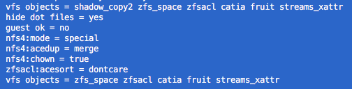

Im going to weigh in here. I'm running 9.10.2-U2 and this is not possible. If I have a replication task for a dataset (pool/dataset) and I then set an SMB share to show a "Periodic Snapshot Task" for pool/dataset, I am unable to remove it. I have put the auxiliary parameters in as advised above and it has shown no change. Also note that this is an instance where Active Directory is running (unable to restart SMB service because it is bound by AD). I also deleted the periodic snapshot task on pool/dataset and then removed all pool/dataset snapshots that had been stored. Then went back and tried selecting the null Periodic Snapshot Task and adding in the Aux Parameters again. The smb4.conf file looks like this: Screen Shot 2017-04-19 at 2.06.59 PM.png
My question at this point is do the Aux Params overrule the previously listed "vfs objects" in the smb4.conf file? If so, problem solved. If not, then this is definitely a bug that needs to be worked out.
Thank you!
Adding the vfs objects line should work. Note that changes to a share definition will not affect current connections to the share. You will need to log out of the Windows client then log back in and access the share to see a change. I created a bug report here: https://bugs.freenas.org/issues/23460

When I did the previous steps, I was not connected to the share and the smb4.conf file did not change (outside of adding "vfs objects = zfs_space zfsacl catia fruit streams_xattr"). Thank you for the bug ticket submission!

Checked with "davlun" and following a reboot, your Aux Parameters one liner did the trick. Sorry for the run around. In any case, the bug should be fixed as one should be able to de-select a snapshot to be viewable to security and data integrity reasons.
