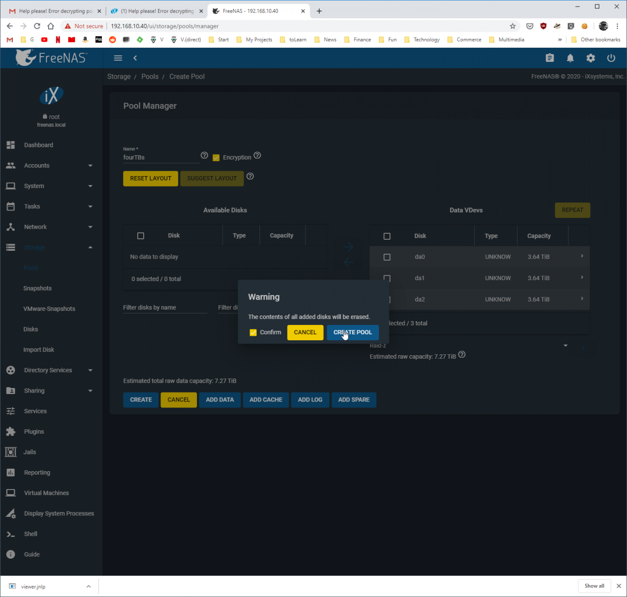

The pool "fourTB.spinners" yes... I wiped... but that was intentional. Preceding this mess I was trying to set the seven 4tb drives I have as a striped mirror (+ one in reserve). I was having a little difficulty because one of the drives was just a tad smaller than the others... but that is a whole other story. Somewhere along the line I thought it might be a good idea for a reboot. Really am regretting that decision.
I never wiped the two other pools: tenTB.spinners or eightTB.spinners

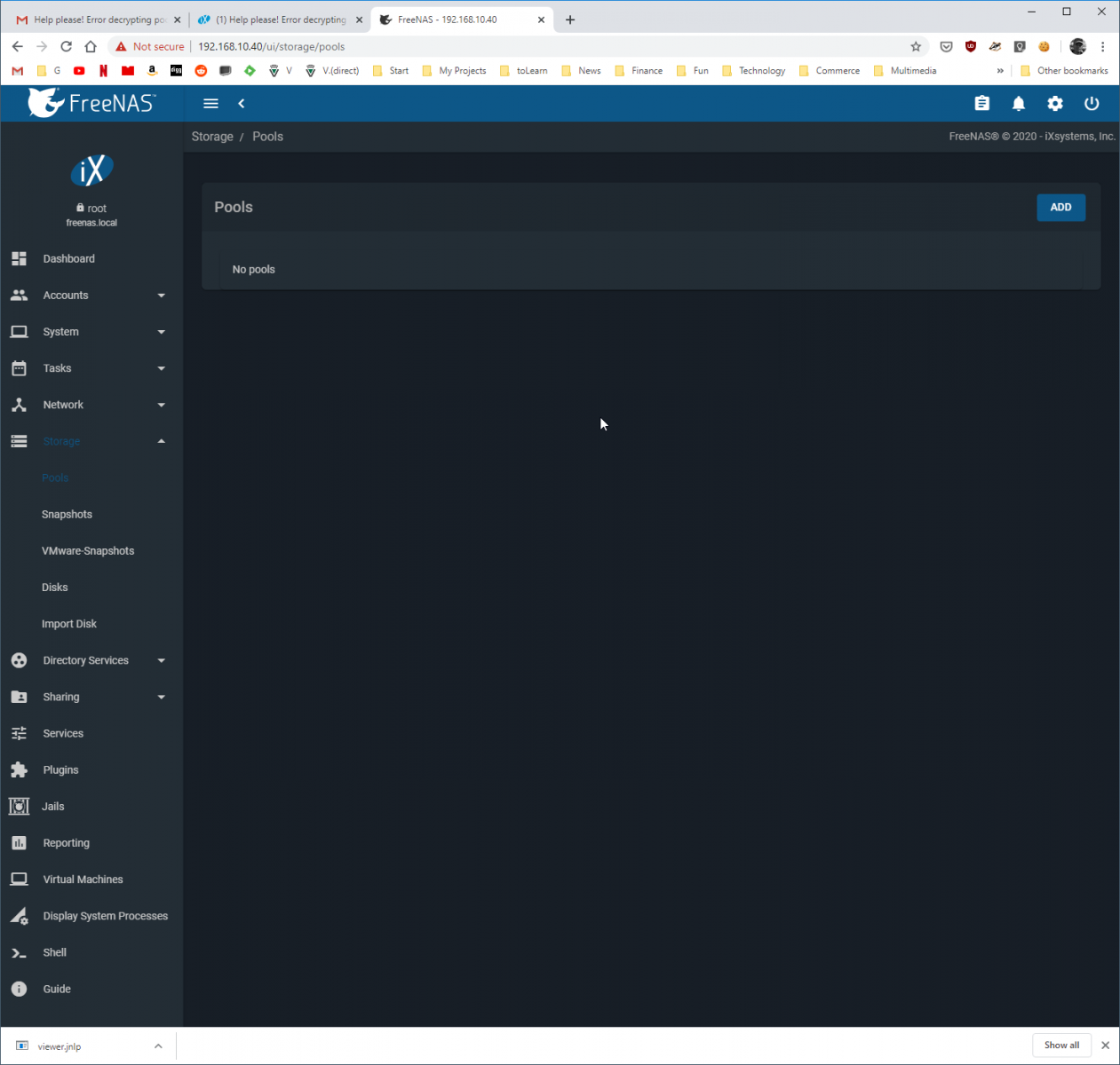

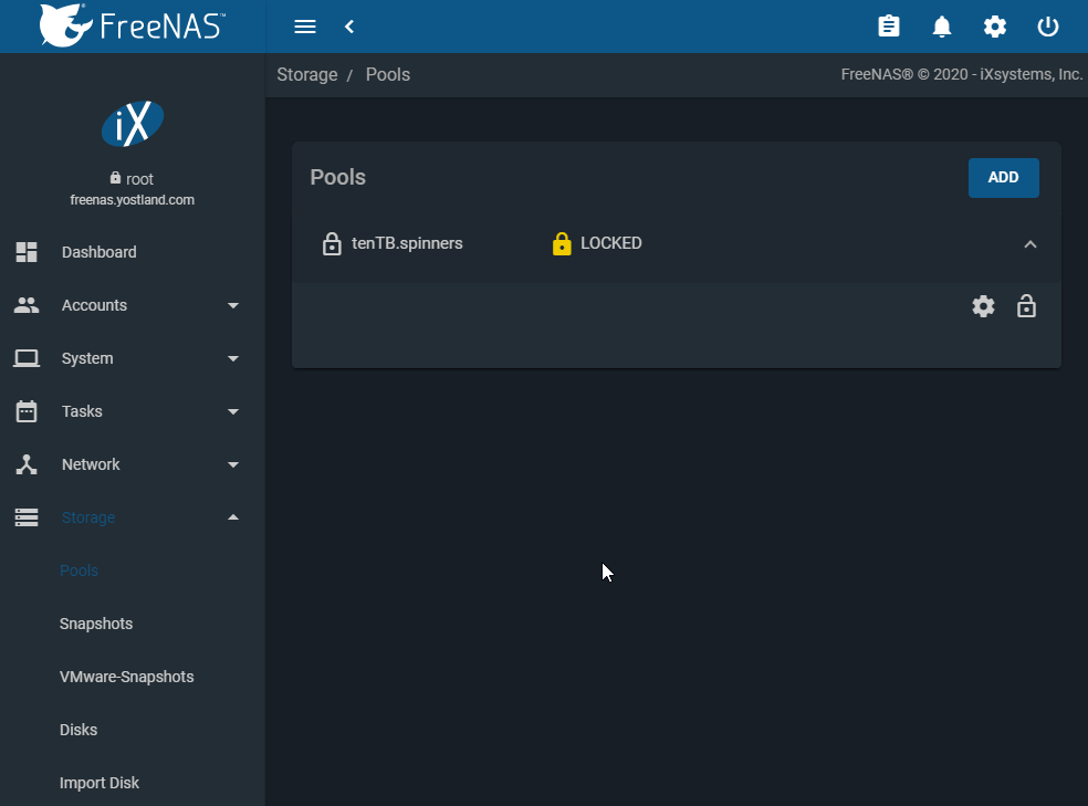

my 'tenTB.spinners' is still sitting in the web ui:
my 'eightTB.spinners' is not there because earlier today I tried to disconnect/reconnect. The problem is no disk populate in the drop-down
Getting late now so going to pick this up tomorrow.
Trouble started at 11:38 this morning (Feb 8th) when I triggered the reboot. I will be digging through the attached logs tomorrow.
If you know of any other for me to look at please let me know.

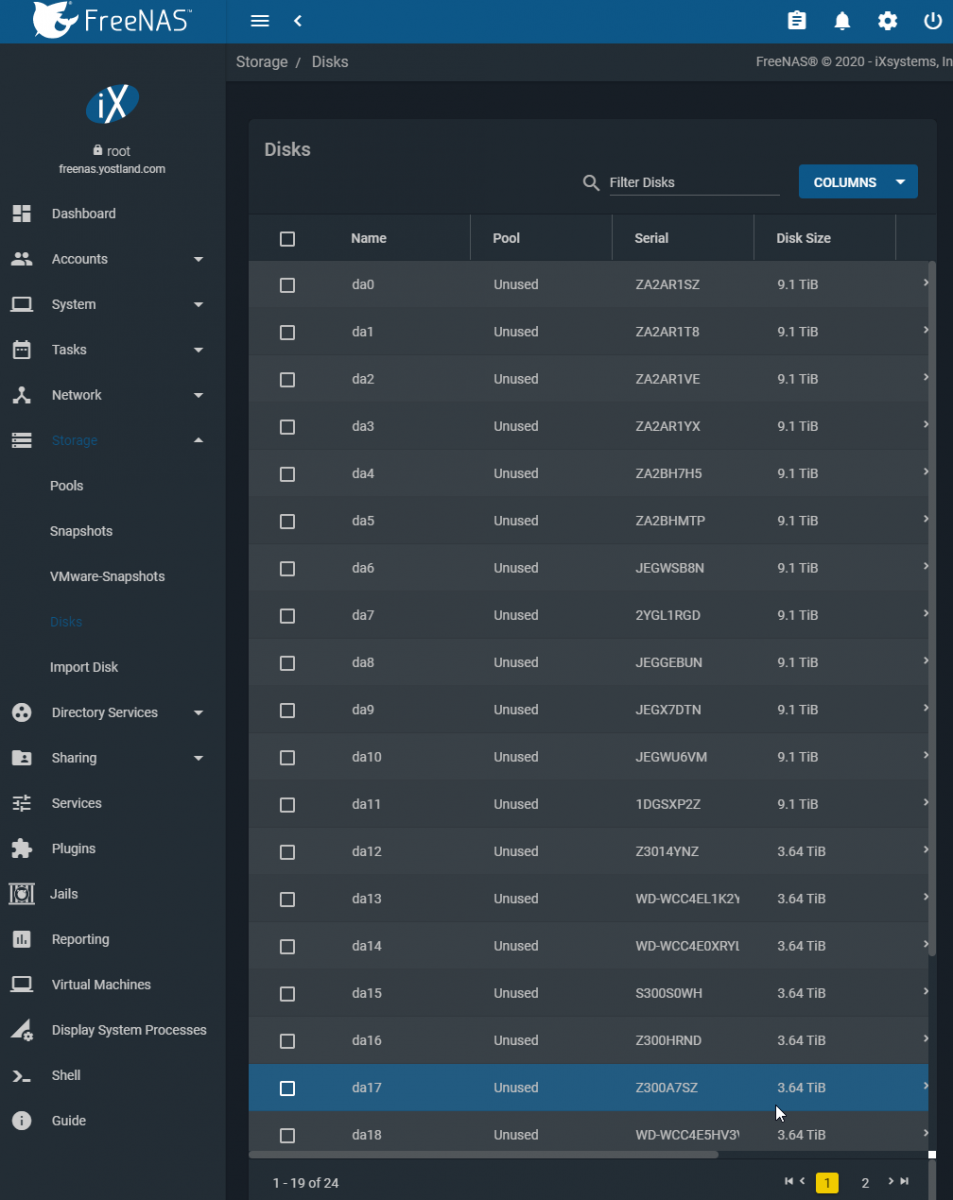

What do you get when you do camcontrol devlist? Are you 100% certain you have all of the data and power plugs fully and properly plugged in? Also, what do you see under Storage->Disks?
theyost
Feb 24, 2019
30
camcontrol devlist give me the following:

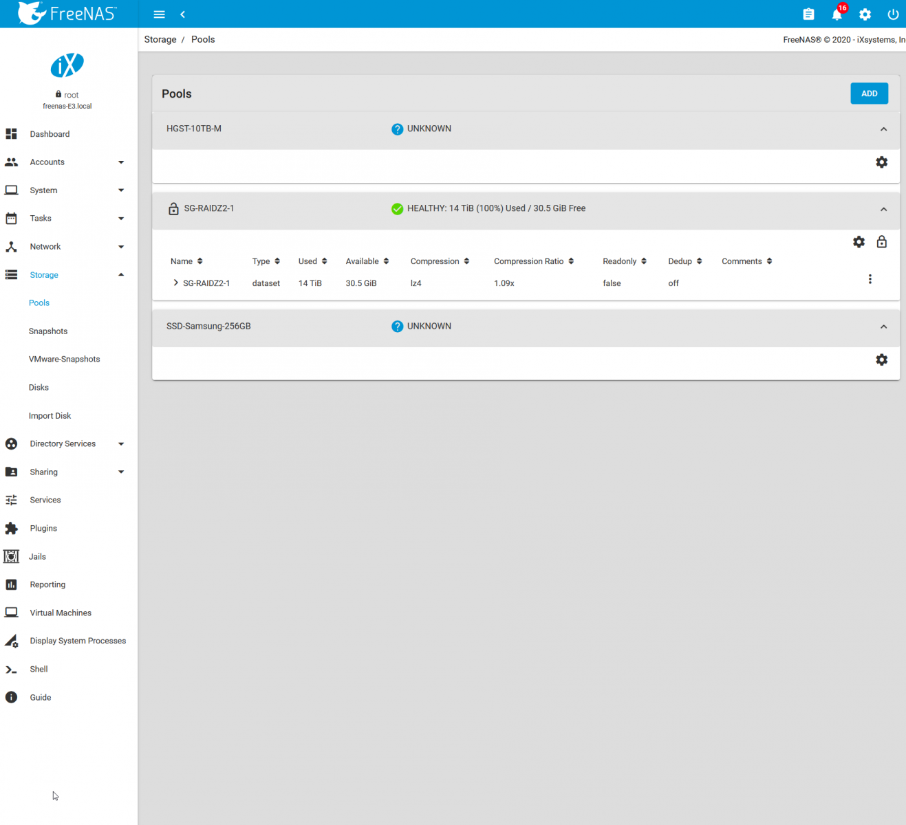

@PhiloEpisteme:
Content of GUI:
Result of "zpool status":

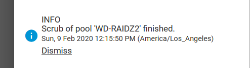

See the "zfs_info_scrub.png", there has been a srcub of the pool, but I don't know if I trust the result as the pool isn't scrubbing and duration was short, yet the pool doesn't exist in the GUI.

Strange that your GUI is showing UNKNOWN on the pools screen. What were the exact steps you took that got you in this situation? I wonder if I can repro it on my system. Sorry if you've said above, I'm having a hard time following every single step. :)

@PhiloEpisteme asked if I can see the disks and the answer is yes:
These are the disks for pool 'eightTB.spinners'
.. (one raid-z1 + encrypted with password)
.. (the physical disks also show up in the webGUI)
<ATA WDC WD80EFZX-68U 0A83> at scbus1 target 17 lun 0 (pass20,da19)
<ATA WDC WD80EFZX-68U 0A83> at scbus1 target 18 lun 0 (pass21,da20)
<ATA WDC WD80EFZX-68U 0A83> at scbus1 target 19 lun 0 (pass22,da21)
These are the disks for pool 'tenTB.spinners'
.. (two raid-z2 vdevs sriped together + encrypted with password)
.. (the Seagate ST1000... drives in one vdev; WD drives in the other)
<ATA ST10000NM0086-2A SN05> at scbus0 target 9 lun 0 (pass0,da0)
<ATA ST10000NM0086-2A SN05> at scbus0 target 10 lun 0 (pass1,da1)
<ATA ST10000NM0086-2A SN05> at scbus0 target 11 lun 0 (pass2,da2)
<ATA ST10000NM0086-2A SN05> at scbus0 target 12 lun 0 (pass3,da3)
<ATA ST10000NM0086-2A SN05> at scbus0 target 13 lun 0 (pass4,da4)
<ATA ST10000NM0086-2A SN05> at scbus0 target 14 lun 0 (pass5,da5)
<ATA WDC WD100EFAX-68 0A83> at scbus0 target 18 lun 0 (pass6,da6)
<ATA WDC WD100EFAX-68 0A83> at scbus0 target 19 lun 0 (pass7,da7)
<ATA WDC WD100EFAX-68 0A83> at scbus0 target 20 lun 0 (pass8,da8)
<ATA WDC WD100EFAX-68 0A83> at scbus0 target 21 lun 0 (pass9,da9)
<ATA WDC WD100EFAX-68 0A83> at scbus0 target 22 lun 0 (pass10,da10)
<ATA WDC WD100EFAX-68 0A83> at scbus0 target 23 lun 0 (pass11,da11)

Both eightTB.spinners (raid-z1) and tenTB.spinners (2x raid-z2) are encrypted with geli.key file and password.

This is what I would expect if tenTB.spinners is locked.
If you see the devices for eightTB.spinners, see it with camcontrol devlist but do not see it under the import encrypted pool my guess is this is some sort of bug.
This is the result I got:
1|HGST-10TB-M|18361101593448120053|0|
3|SSD-Samsung-256GB|16363495742609563155|0|
8|SG-RAIDZ2-1|7028857175536165607|1|3e791190-7177-4b4b-bc09-5e28e08961a3
The steps I used were as follow:
I tried with frsh install of 11.2-U6, then 11.2-7 and then 11.3 RC2 and 11.3 Release and I wasn't able to get proper import. The system is curently located in another location and I should have access to it sometime this week. I should have a backup of the latest config over there so I might be fine doing another fresh install and restore the config.
However, as it is, I have tried importing the pool for WD-RAIDZ2 without success. The steps I have followed are as follow:

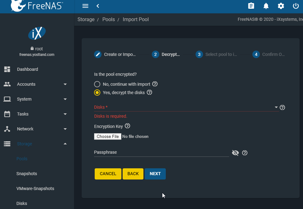

Select the import encrypted disk from the GUI. From another instance of the Web interface, I displayed the disk allocation and serial number so I could tel which disk is part of the proper pool.
So I select the disk one by one from the list and then upload the geli.key file. I press next and in the Pool drop-down the pool name would appear. I select it and then proceed with the import. After a while, I get an error message in the GUI.
What I have seen a few times in earlier version of Freenas, such as Coral until now, is that the GUI can fail if volumes defined in the GUI but missing from the system would cause encryption disk/pool import to fail.
Maybe having more than one encrypted pool in the system is also causing the problem.

I am fortunate to have twin hardware to tinker with so I thought I would start fresh and maybe practice there. Both machines are Dell r720xd with JBOD controllers. The old/broken FreeNAS box is sleeping right now.

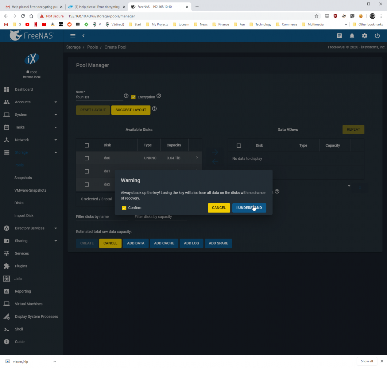

What is crazy is I can't even create an encrypted pool on a fresh FreeNAS (11.3) install (image downloaded today). I first tried UEFI (set both in hardware and software). The second go-around is with Legacy BIOS (set both in hardware & software). Same results... I a bunch of screenshots just to prove I am not crazy:
Log in first time to fresh FreeNAS 11.3 install and then...
storage->pools
Click "Add" + "Create new pool"
Encryption: <yes>
Warning: <confirm> and <I understand>

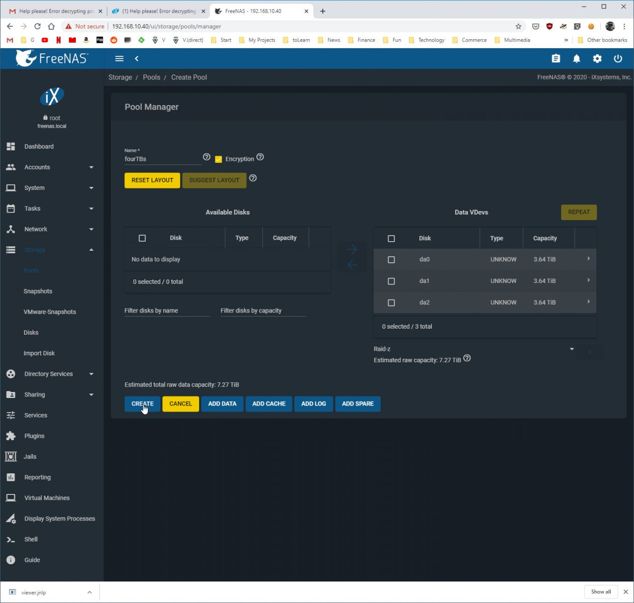

Move three disks over
Default is raid-z. I am okay with that
Click "Create"
<confirm> warning + <create pool>

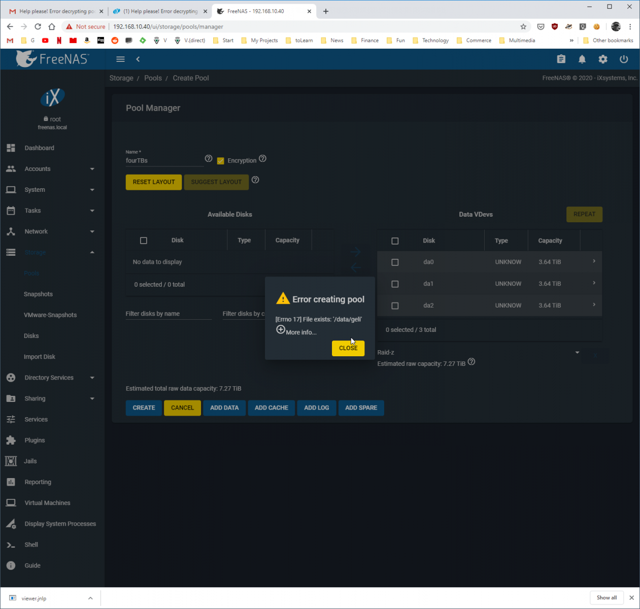

& I get an error.

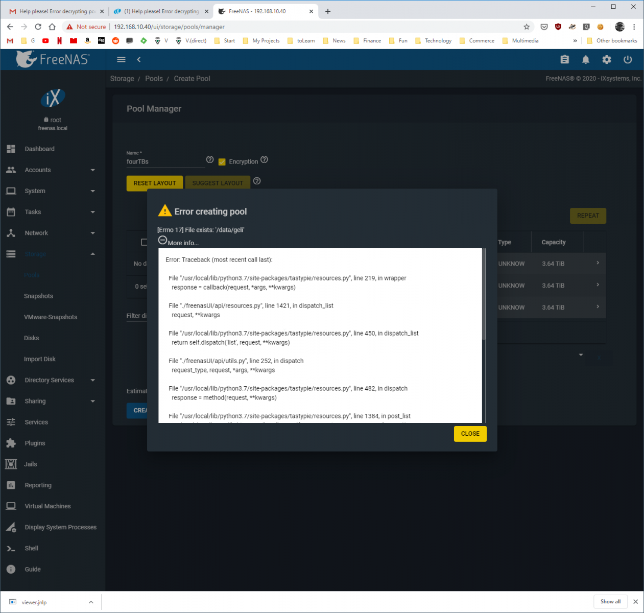

File "/usr/local/lib/python3.7/site-packages/tastypie/resources.py", line 219, in wrapper
response = callback(request, *args, **kwargs)
File "./freenasUI/api/resources.py", line 1421, in dispatch_list
request, **kwargs
File "/usr/local/lib/python3.7/site-packages/tastypie/resources.py", line 450, in dispatch_list
return self.dispatch('list', request, **kwargs)
File "./freenasUI/api/utils.py", line 252, in dispatch
request_type, request, *args, **kwargs
File "/usr/local/lib/python3.7/site-packages/tastypie/resources.py", line 482, in dispatch
response = method(request, **kwargs)
File "/usr/local/lib/python3.7/site-packages/tastypie/resources.py", line 1384, in post_list
updated_bundle = self.obj_create(bundle, **self.remove_api_resource_names(kwargs))
File "/usr/local/lib/python3.7/site-packages/tastypie/resources.py", line 2175, in obj_create
return self.save(bundle)
File "./freenasUI/api/utils.py", line 493, in save
form.save()
File "./freenasUI/storage/forms.py", line 282, in save
return False
File "./freenasUI/storage/forms.py", line 279, in save
}, job=True)
File "/usr/local/lib/python3.7/site-packages/middlewared/client/client.py", line 513, in call
return jobobj.result()
File "/usr/local/lib/python3.7/site-packages/middlewared/client/client.py", line 276, in result
raise ClientException(job['error'], trace={'formatted': job['exception']})
middlewared.client.client.ClientException: [Errno 17] File exists: '/data/geli'
I am without words. When it rains it pours.
Could it be a driver issue?
PhiloEpisteme can you... can anybody re-create?

I am curious if your issue has to do with the following line in your config.
What if you do the following . . .
Go ahead and check the output of sqlite3 /data/freenas-v1.db 'select * from storage_volume;'. I expect that you'll see only one for tenTB.spinners. Compare that against the files you see in /data/geli. Whichever of the files in [/icode]/data/geli[/icode] that you do NOT see in the output of the sqlite3 command go ahead and rename them as follows, mv /data/geli/<key>.key /data/geli/<key>.key.bak. This is not destructive, you can always move it back. Try that and then try creating the pool.
