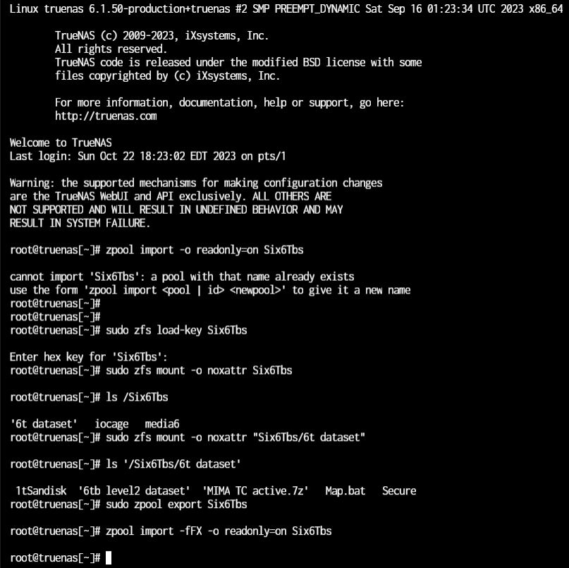

My 6*6tb pool named "Six6Tbs" cannot be imported at powerup as it goes to kernel panic. I physically disconnected the drives so the computer can boot, and I can have access to a working shell. Here are the commands that works:
zpool import -o readonly=on Six6Tbs
sudo zfs load-key Six6Tbs
sudo zfs mount -o noxattr Six6Tbs
ls /Six6Tbs
sudo zfs mount -o noxattr "Six6Tbs/6t dataset"
ls '/Six6Tbs/6t dataset'
sudo zpool export Six6Tbs
zpool import -fFX -o readonly=on Six6Tbs
However, anything that is not readonly does not work. I also cannot set the readonly to off when it is already imported.
Any recommendations? Much thanks!

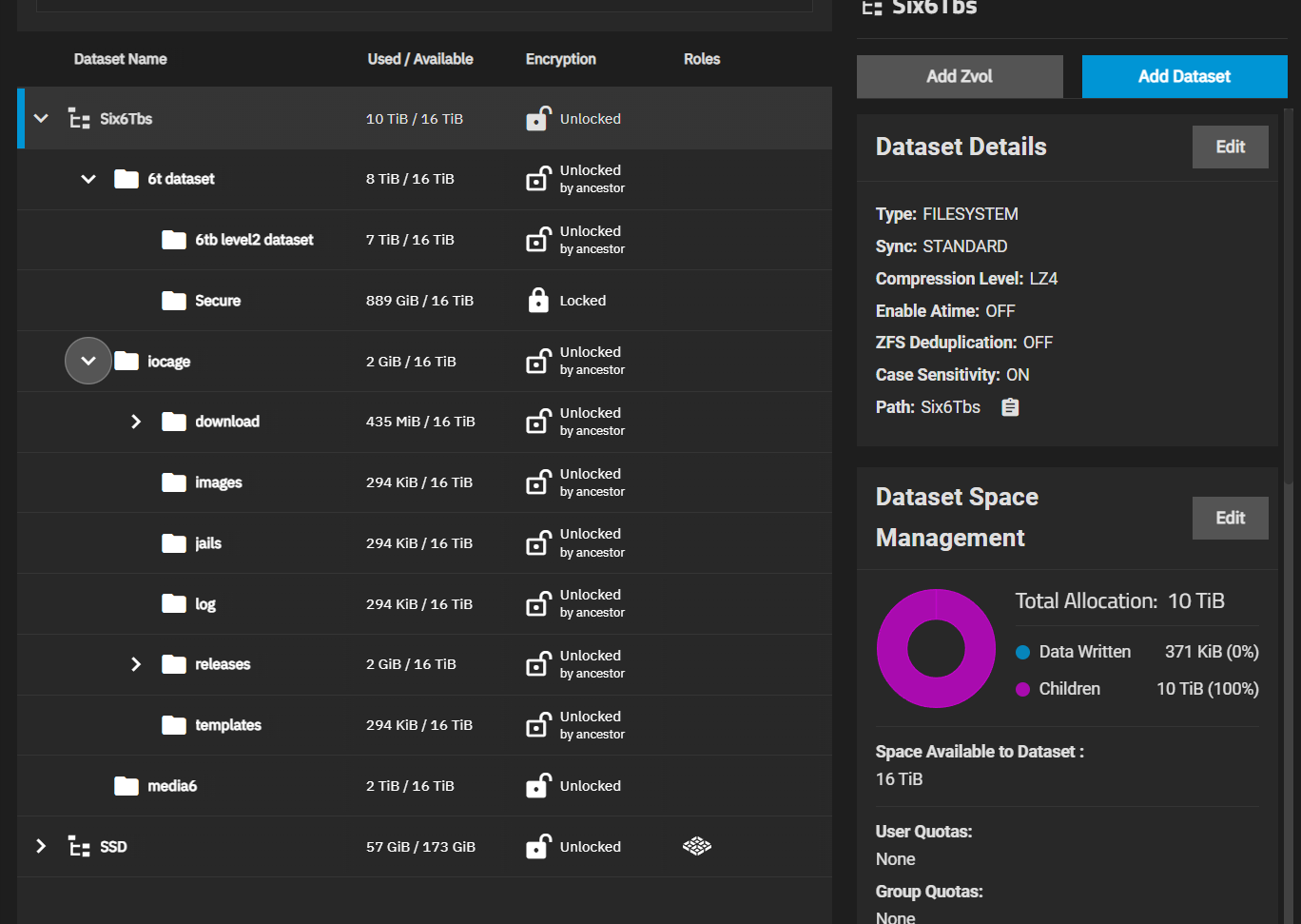

Updated to the latest RC release. Attached is an image for proof of what works

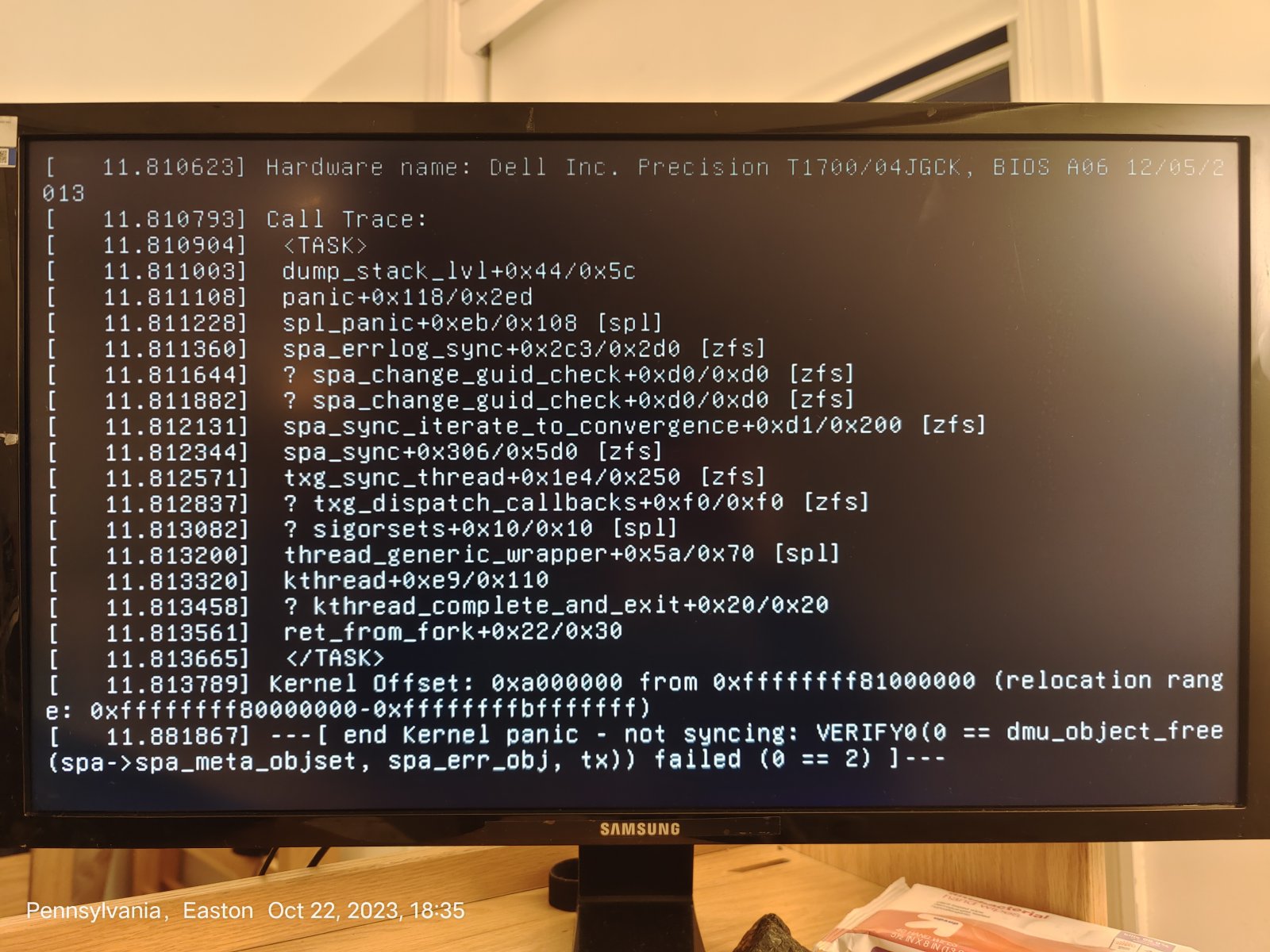

Attached is what happens when I import it regularly (not readonly) as it fails and enters panic:
No more terminal output. Below is GPU output and it crashes

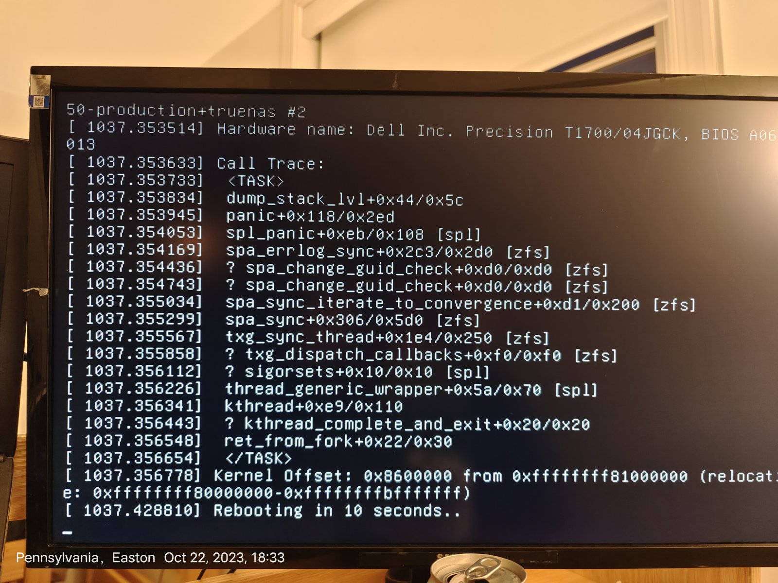

After it reboots, it fails and stuck on this page:
It stays like this for over two days with no disk activity.

As I can see, the panic happens when ZFS tries to sync error log for the pool, hitting error trying to free some space, that is not supposed to happen and not so handled otherwise. It is difficult to say what is the cause, it could be some earlier pool corruption. I may speculate that the error log it is trying to sync may actually have something to do with the corruption. It does make sense that read-only import succeeds. Unfortunately I don't know a way to recover from this situation without data offload and pool recreation.

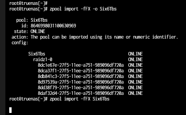

Thank you all very much! I have attempted setting readonly to off when the pool is mounted because someone on youtube has been able to do that, and export the pool properly, and that seems to fix the pool for the next input. Unfortunately, when I try to modify the readonly setting I am prompted I can only change such settings when attaching the pool; but if I do that the system freezes and enters panic.

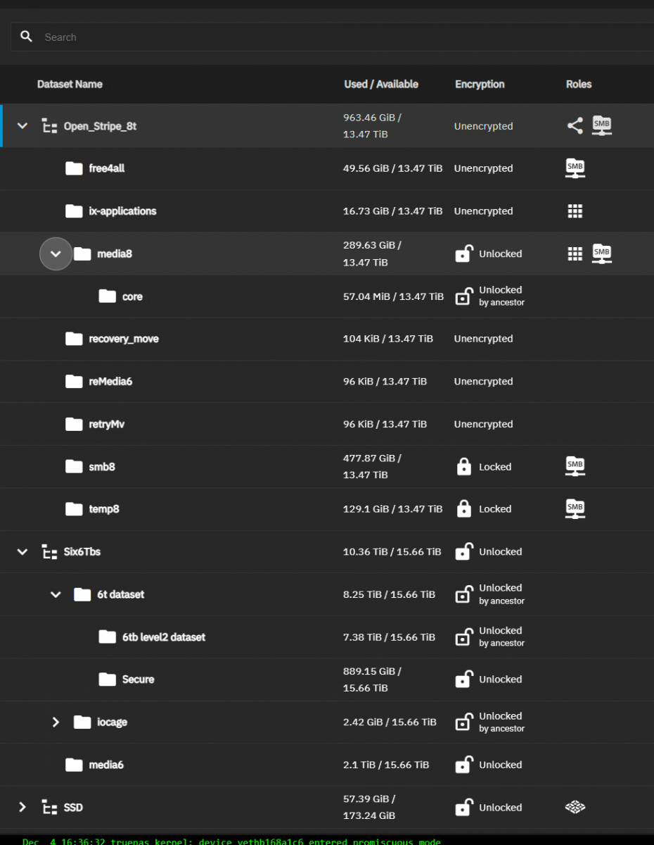

Here is the plan:
1. Move as much as possible onto the existing 2x 8tb pool.
2. Unplug a 6tb, plug in a new 8tb drive. Expand existing 2x8tb pool
3. Move some more stuff to the 3x8tb pool
4. Unplug another 6tb and plugin another 8tb, expand to 4x8tb pool.
5. Wipe and make new 4x6tb pool
6. Move data for backup.
7. Sell the 2x 6tb drives
Haibane
Oct 22, 2023
18
Unable to copy. Or copy only to boot-drive.
Tree breakdown:
to
'Open_Stripe_8t/recovery_move'
from
'Six6Tbs/6t dataset/Secure'
'Six6Tbs/6t dataset/6tb level2 dataset'
Above is as displayed in the GUI web interface under Dataset.
