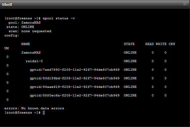

I ran "Zpool status -v" in the shell via the browser-based GUI and got a whole bunch of lines. The important one: No known data errors. It also said "No scan requested" and I got zeros everywhere. I'll include a screenshot in a second.
Also, thanks for the fast response!
Edit: Including picture
