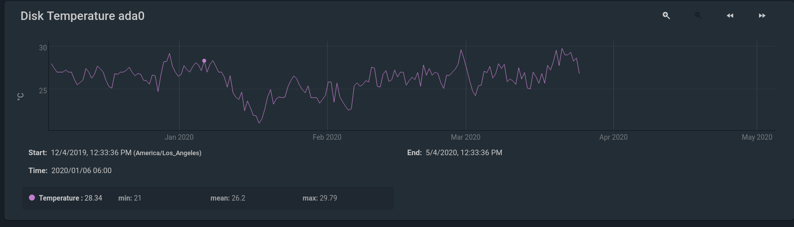

yeah, I read that thread and NAS-103898 doesn't really address what I'm seeing..unless it does? I'll add a screenshot for clarity:

Oops, I don't see a way to edit my post above -- basically even a place for me to go look for logs would be nice. I'm not knowledgeable of FreeNAS yet so I don't even know for example where the time series data (I assume it's stored as that) for disk temps is stored, and I don't know what's doing the writing, or what's reading it from the disks. If anyone could pass a few pointers about what logs to check I'd be very happy to try to find my own solution.

OK, so you have the display for the temperatures but its not updating ... (I didn't get that from your first post).

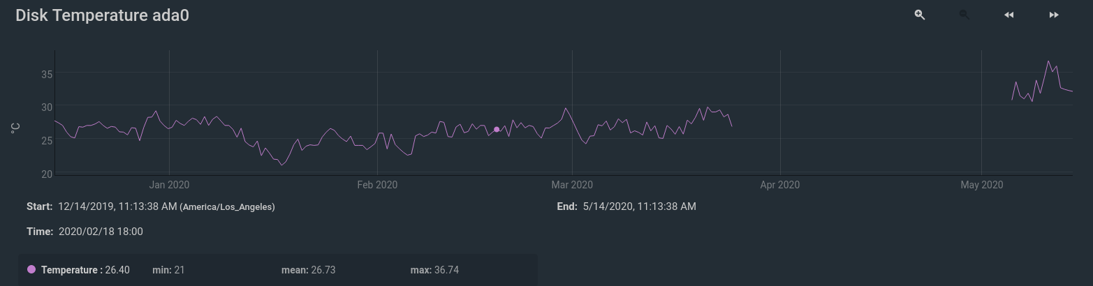

And as some food for thought, I checked the temperature graphs today... It looks like all of the disks started showing temperature data 2020/05/05 at 12:30 pacific time -- except for one! To re-iterate from my initial post: The only changes I've done were on the 7th, which (to paraphrse) involved disabling the disks' power-saving settings.
supersean
May 7, 2020
6
To continue from the bottom of my recent post -- the last disk that wasn't showing temperature data DID have power-saving settings turned on. I think this is because when I disabled the settings on the 7th (or was it the 5th? o_O ) I performed a bulk-edit from the WebGUI on all 7 disks. 6 are HDDs, but the disk in question is an SSD.
I went back and checked when I made changes to the disk temp settings ... I'm confident I changed them on the 5th, but you don't see any disk temp data in May in the screenshot I posted above! Here's a screenshot today:
I think the lesson I've learned (again) is to write down all the changes I made when. I appreciate you guys for helping me on this. I double-checked the manual too...
