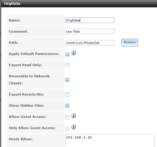

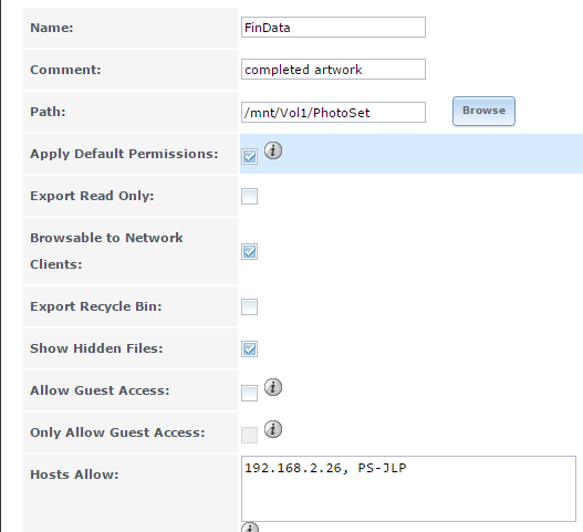

Yes they did for a good while, then I had to shut down the network due to some electrical work being done of a period of time.
Name is FinData
/mnt/Vol1/Photoset
[root@freenas ~]# getfacl /mnt/Vol1/PhotoSet/
# file: /mnt/Vol1/PhotoSet/
# owner: Jon
# group: NasUsergrp
owner@:rwxpDdaARWcCos:fd----:allow
group@:rwxpDdaARWcCos:fd----:allow
everyone@:r-x---a-R-c---:fd----:allow
I use 2 names for the same location because in that location there are 2 types of images (finished .tiff and original images .cr2).
I use Shadow Protect to access these files from my desktop and stored them on the FreeNAS system.
The only user accessing the system at the moment is myself (Jon).
I'm not sure what you mean by the last question, however its a CIFS share with a file mask of 0660 and a Directory mask of 0770
Guest account is Jon
Home Directories is /mnt/Vol1
Unix Extensions is ticked
Zeroconf share discovery is ticked
server min protocol is SMB2
server max protocol is SMB3_00
Allow execute always is ticked
Bind ip address is ticked to the ip of the server
