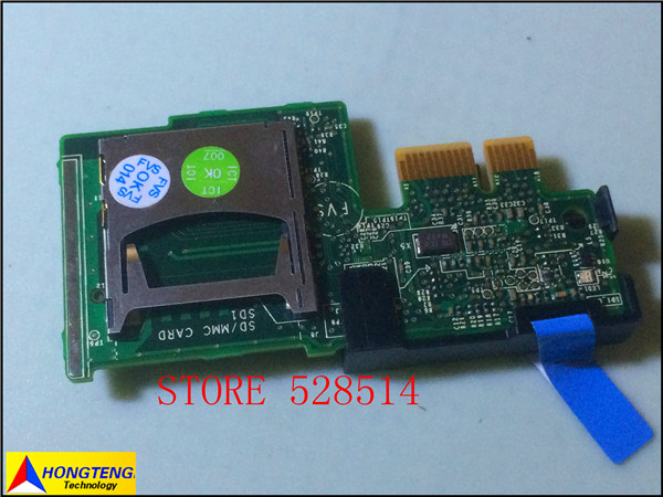

Our R720 didn't have 2.5 SSD space(both internal and external), but it has a USB port in the motherboard and can install a 2 SDCard slots(mirror) reader in the case(a extend card, looks like a PCI-E x1 card, price about 35 USD).

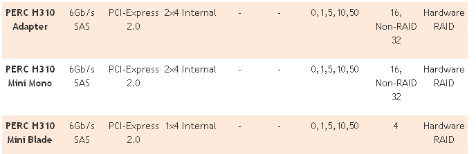

  2. Per the "Dell PowerEdge RAID Controller H310" PDF
    • It lists the "SAS Controller" as "LSISAS2008"
    • It shows "Non-RAID: 32" under "Maximum number of physical devices" (Also lists other RAID Modes, but that doesn't matter)
Now, I did notice this - Per "Dell PowerEdge RAID Controller (PERC)":
So, I guess that it would come down to if you have the "Mini Mono" or "Mini Blade"? Kind of weird though since they are are based off of the "2008".
