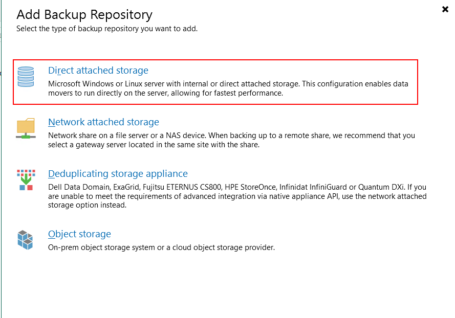

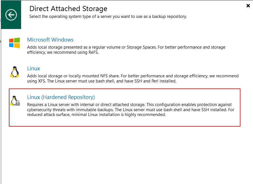

I am trying to add repository like this.
Which option do you use in add backup repository in veeam backup?

As mentioned in tutorial, you should add the repository as an SMB share, not a linux hardened repository.
It is perhaps a bit unclear in the tutorial, but this tutorial uses a different way of hardening the repository (creating immutable backups), compared to the Veeam default way. So you have 2 possibilies :
- You setup a default Linux install and go the Veeam route : Use "Linux (hardened repository)" and Veeam will to the hardening for you.
- Or you go the alternative route using TrueNAS scale. This is a different (but I think not less secure) way of creating an immutable repo. But if you go this TrueNAS scale way, it is done via SMB.
(I would 've preferred that the tutorial used iSCSI instead of SMB).
