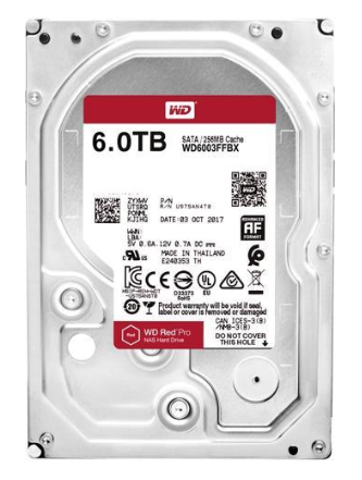

We have a server that was delivered with 60 of the WD Red Pro drives, like this:

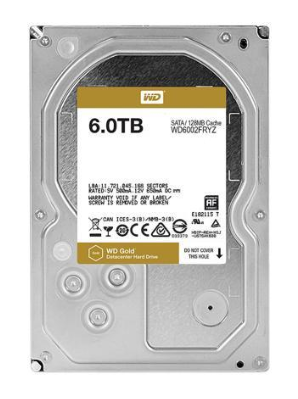

We have lost four of those drives to drive faults and replaced them with the WD Gold drives, like this:
For us, at the time of purchase, the WD Gold drives were less expensive. Looking at New Egg just now, that is not the situation. At this moment, the Gold drives are running about $55 more, for the 6TB size, but it might still be worth it if the failure rate is lower. So far, we have had zero errors from the Gold models tested and zero errors from the ones in service.
