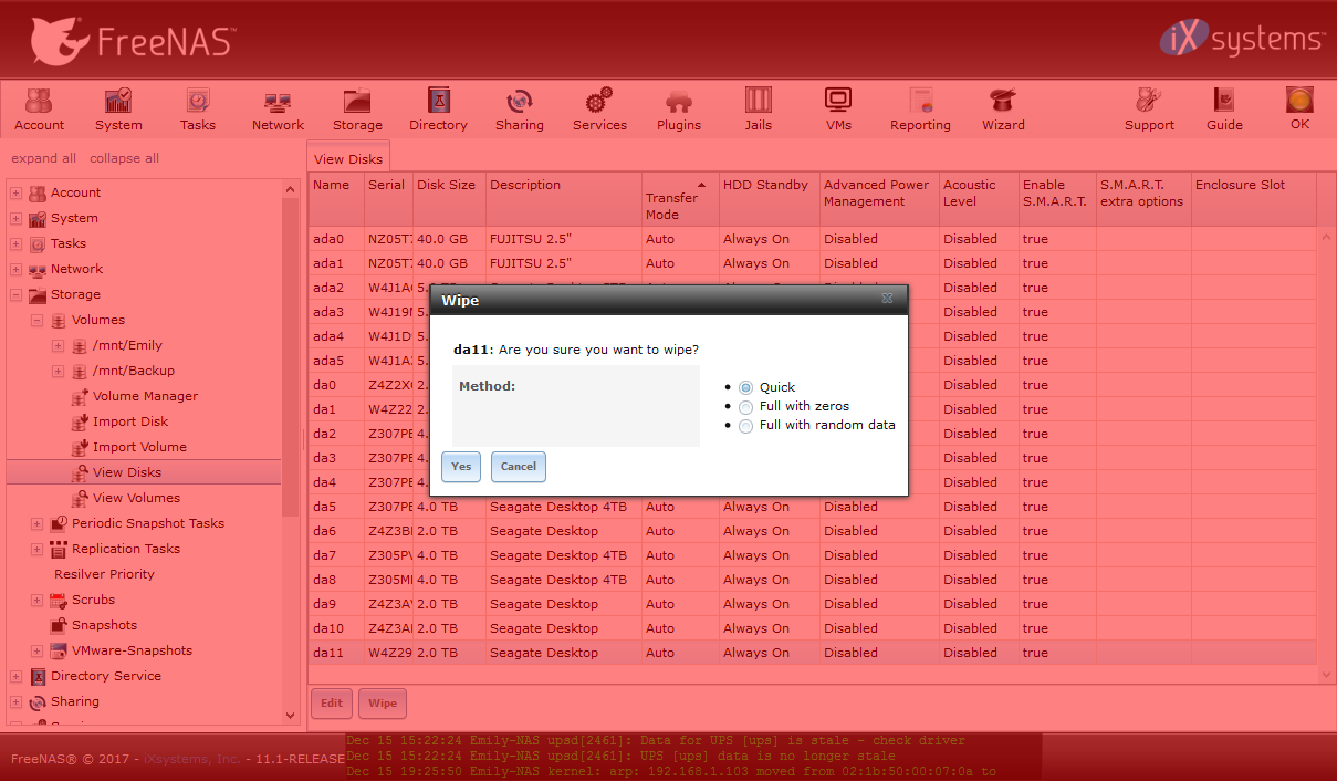

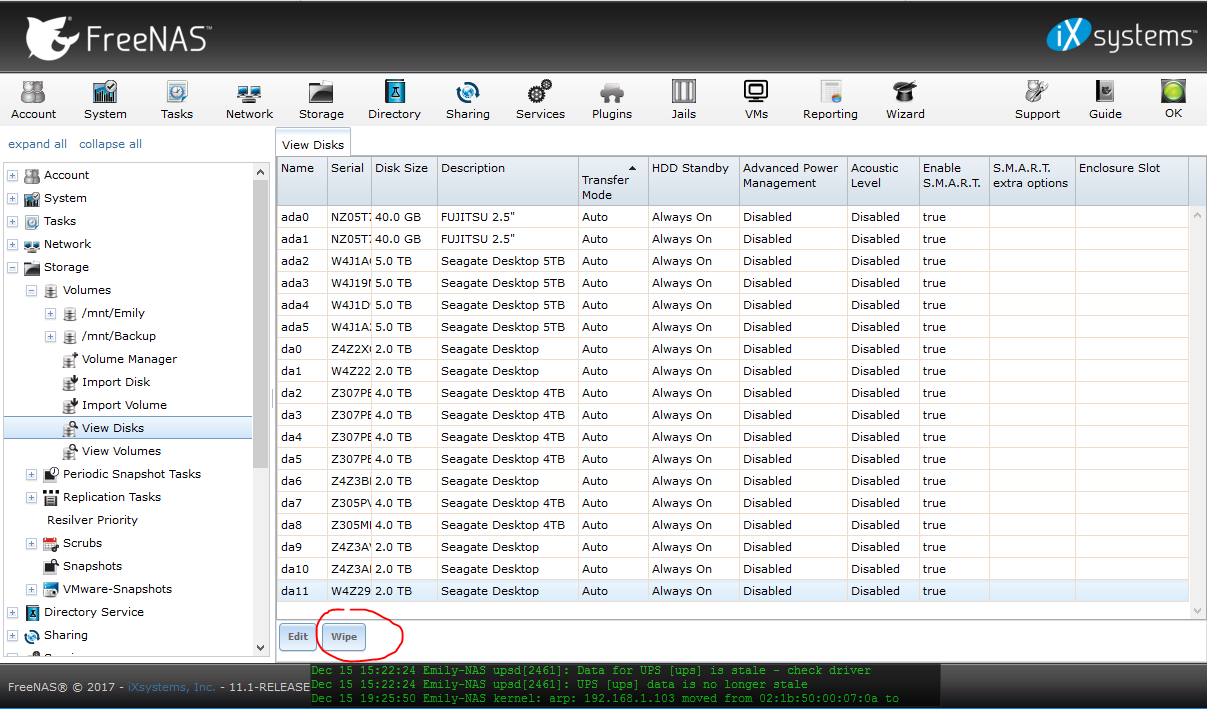

Would it totally freak out because the failed drive was rebuilt onto another drive but now the original is back, or would it consider the drive defunct and give me an option to blank it and treat it as new?
It wouldn't do anything, including to pop-up any option to clean the drive. You can tell the system to clean the drive. That would be a good thing if the drive is still partitioned. The testing I do completely erases the drive, so it isn't needed, but if you don't clean the drive in any way, it will just sit there waiting for you to do something. If you try to use it as a replacement without cleaning it first, you will get an error. The nature of the error depends on the exact circumstances.
If it can't be put back without blowing something up and I need to destroy the volume or something before putting it back, that's fine too as right now I'm mainly testing it, and frankly, I probably could set it up better for iSCSI than I have.
You have options. I usually clean the drive in another system before reinserting it in the storage system. You can do a full wipe of a drive that is in the NAS.
