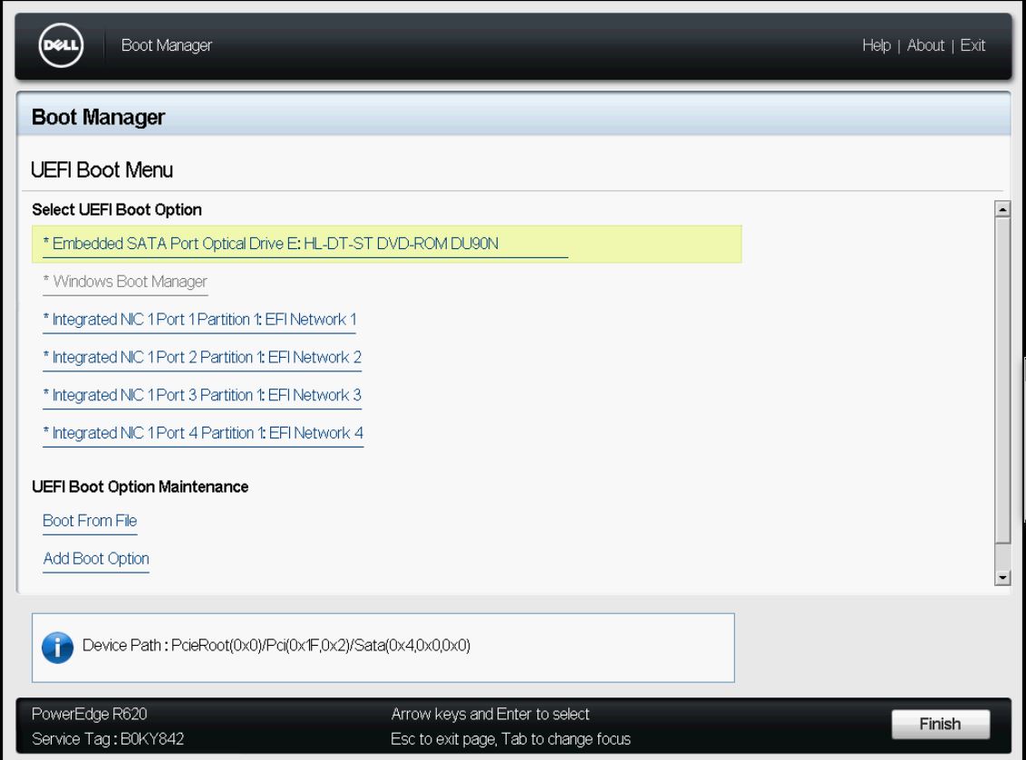

I just flashed my H310 mini in a Dell R620. Followed the guide and also flashed with both BIOS and UEFI since my boot drive is off of the controller. I'm pretty sure I installed Server 2019 in UEFI, but when I try to boot off the H310 via the UEFI boot menu the Windows Boot Manager is greyed out. I tried booting via BIOS which detects my C: drive but it blue screens with inaccessible boot drive, which leads me to believe I had it installed via UEFI (which is what I prefer). I went back into the Linux live and flashed again the UEFI bootloader, but it's still greyed out. Any Ideas?

Any Ideas?
Shot in the dark here - but when you reflashed the controller from "Dell PERC H310" to "LSI 9211-8i" perhaps the Dell UEFI firmware is hunting for it by PCI vendor/device ID and can't find anything because it's looking for a PCIe device that isn't there any longer?
See if you can manually add it from the "Add Boot Option" and plug in "EFI\Boot\BOOTX64.EFI" as a path; not sure what EFI filesystem it'll be under but it should be browseable, or you can pop an EFI shell and look interactively. If not, boot from your Server 2019 install and see if you can do an "automatic troubleshooting" or "repair boot" or similar.

Thanks for the ideas, unfortunately nothing worked. I couldn't even repair with the install disk. I ended up just reinstalling Server 2019 and Hyper-V and adding back into the cluster. Everything seems to be working fine, and disks finally show as SAS in storage spaces instead of RAID. Got one more to do, I imagine I'll be reinstalling Windows on it too.
