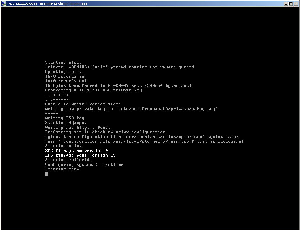

anyway here's attached a screenshot from booting sequence.
I looked into that /usr/local/etc/nginx/nginx.conf, it looks good :)
I have attached a screenshot of this thing too.
but as the first impression was this is a lousy thing, and as the manual is not very helpful (the freaking "Section 2: Using the Graphical Interface" should start with something like:"point your browser to the http://x.y.z.w/url/url/url address", before you go set the admin password you should be able to access the bloody thing :))) )
root location of this nginx seems to be /usr/local/www/nginx-dist which contains the beautiful 151bytes "index.html" file with the well-known "welcome to nginx!", a "50x.html" file and a file "EXAMPLE_DIRECTORY-DONT_ADD_OR_TOUCH_ANYTHING"
