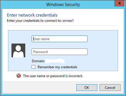

I have setup Active Directory integration which is working fine but now I want to use guest access on the same share in order for non AD users to get read only access.
It sort of works already which means when you trying to connect to the share with a non AD account you get a username/password prompt where you can enter a fake username and see the files.
Is there a way to get rid of the logon prompt?

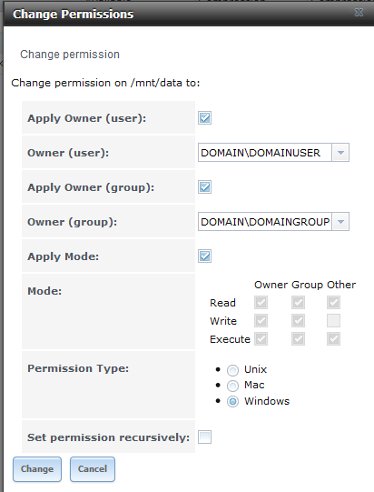

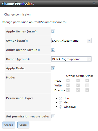

I have set the permissions in the following way:
And I can see that everyone has the following rights on the share:
Read & execute
List folder contents
Read

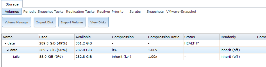

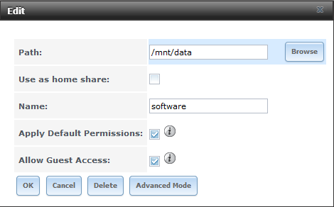

What does your share settings look like?
It looks like you are directly sharing your root dataset? Is that correct? If so, you'll want to rework your setup. Sharing your root dataset was allowed by previous versions, but it has never been a supported setup. You'll want to create a child dataset, and share that. This may explain some of the weird behavior.

It looks like this:
Maybe I should have called it something else than data :smile:
Nick2253
Apr 21, 2014
1,633
Ok, so yes, you are sharing the root dataset. What you are seeing there is:
data (pool)
	data (root dataset)
		jails (child dataset)
What you want is something like:
data (pool)
	data (root dataset)
		share (child dataset) <-- sharing this dataset via SMB/NFS/Whatever
Can you please post a screenshot of your share settings?

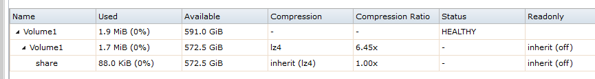

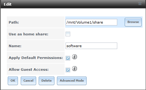

and I have set the domain level permissions on the share child dataset.
But the result is the same as before.

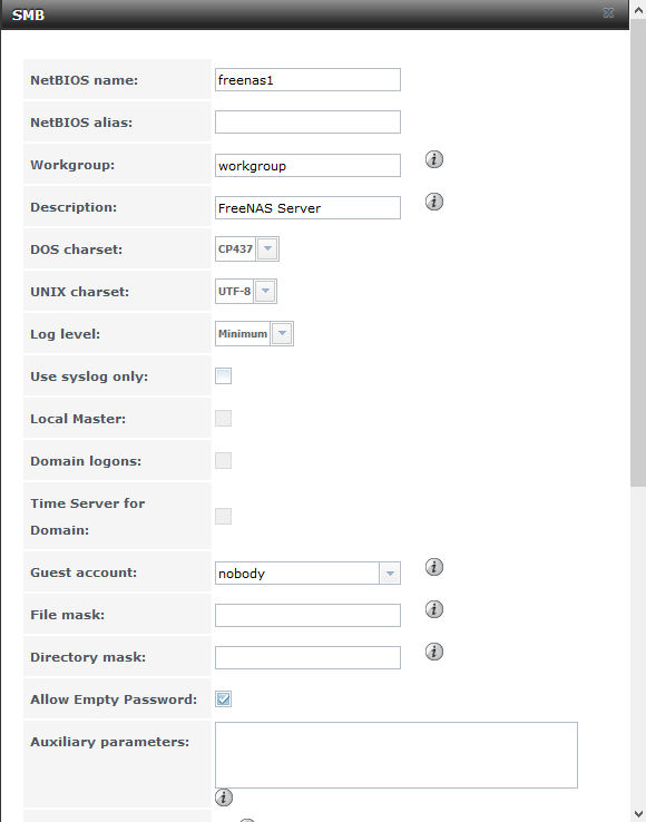

I have also activated "Allow empty password" for the SMB service but the behavior is still the same. Non domain users get a log on prompt.

I followed the steps and accessing the share with a domain member account works fine but still the read only guest access for machines outside the domain prompts for username and password but you can enter a non existent username and it logs you on.

  • Non-domain user connects to server. Automatically connected with "guest" credentials. <-- Not happening. Non-domain users getting password prompt
