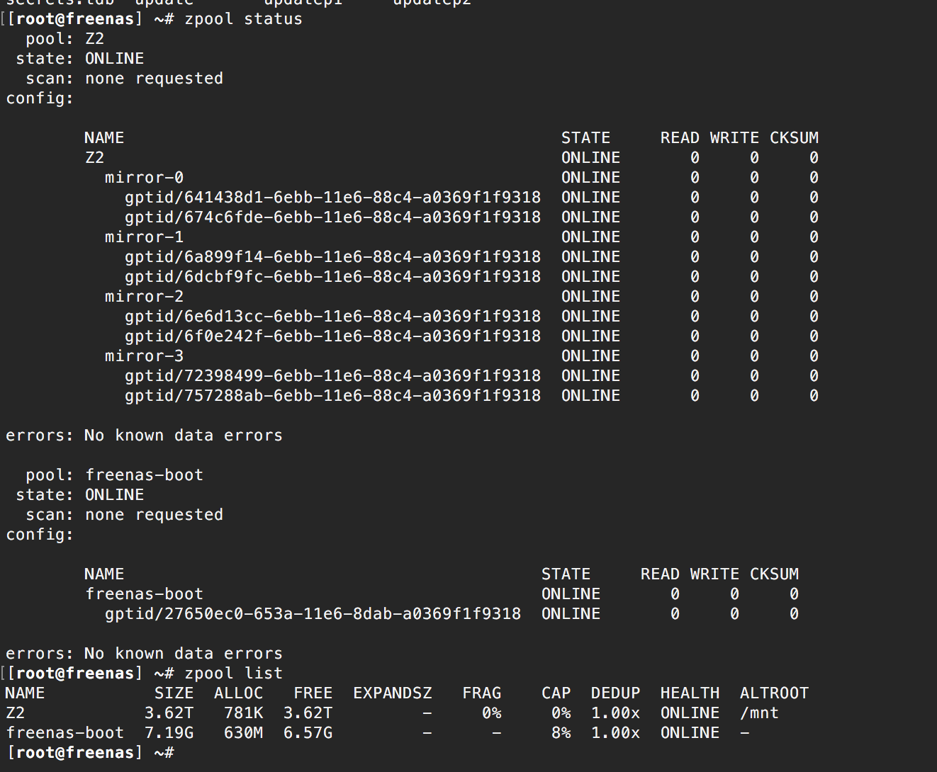

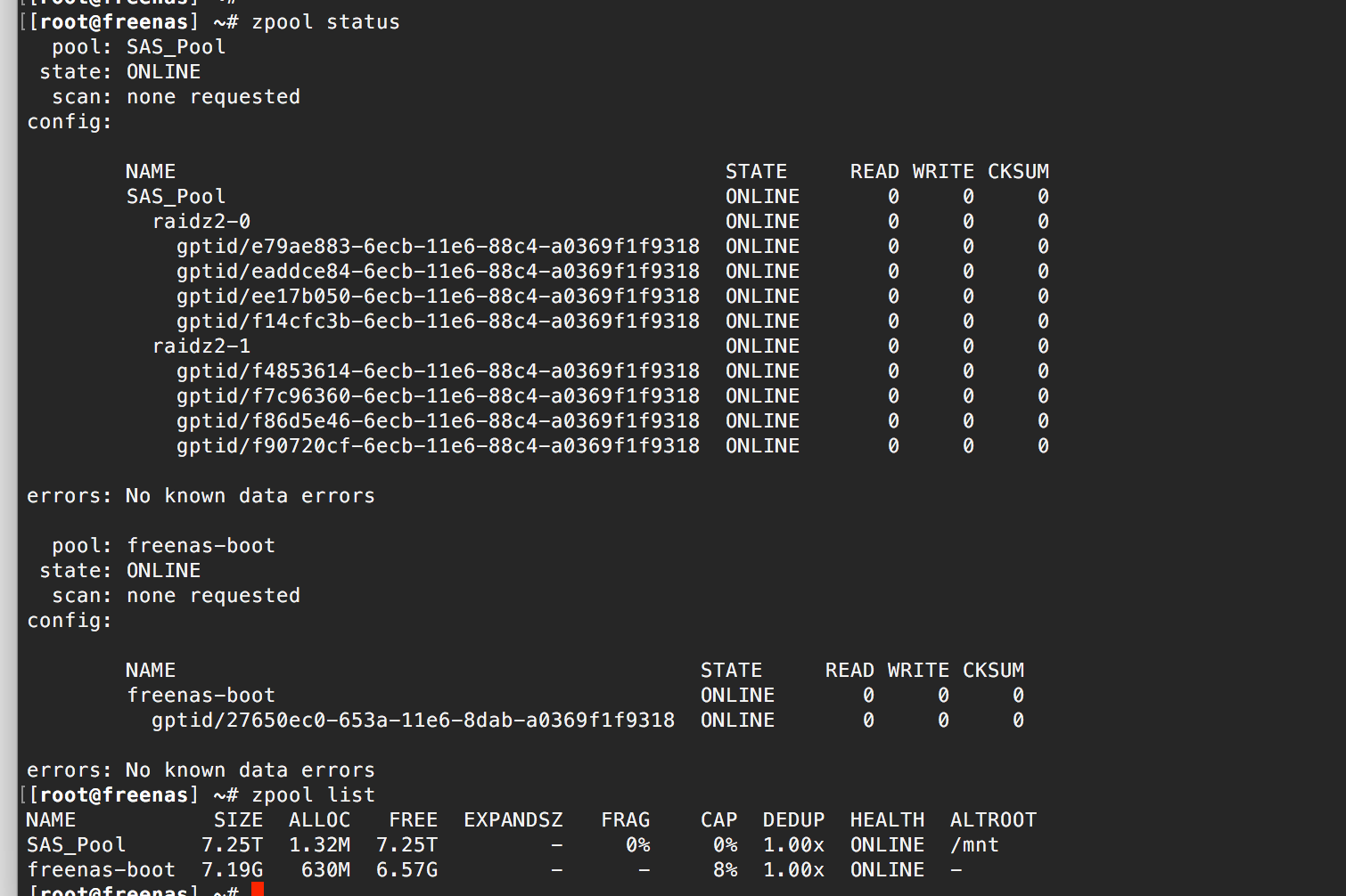

Maybe I am stupid, but I add via that drag web gui tool, a 4 SAS mirror raidz2, it was raidz2-0 and raidz2-1, performance was nothing better than raidz2 with 8 disk.
Now I deleted the pool, and created 4x Mirrors (always with "add extra Device") and hit add volume.
On screenshots you can see what was created. Is it a 4x mirror raidz2?
I can't see it.
It is 4 mirrors striped, not RaidZ2. Notice in the screen shots they say "mirror-0", "mirror-1", "mirror-2" and "mirror-3"? That is 4 mirrors. Wondering why it is called "Z2"? That name for the Pool/Volume is a little confusing, makes one think of RaidZ2... ;)

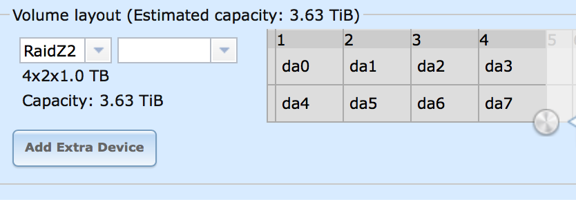

Ok, once again :smile:
Is it now how it would be recommended?
It look for me like 2xraidZ2 mirrored.
I thought it would be better to have 4x mirrors and with this a raidz2?

That is two RaidZ2 vDevs (Not mirrored). At this stage I am not too sure what layout you actually want since you keep mixing up types of vDevs... lol.

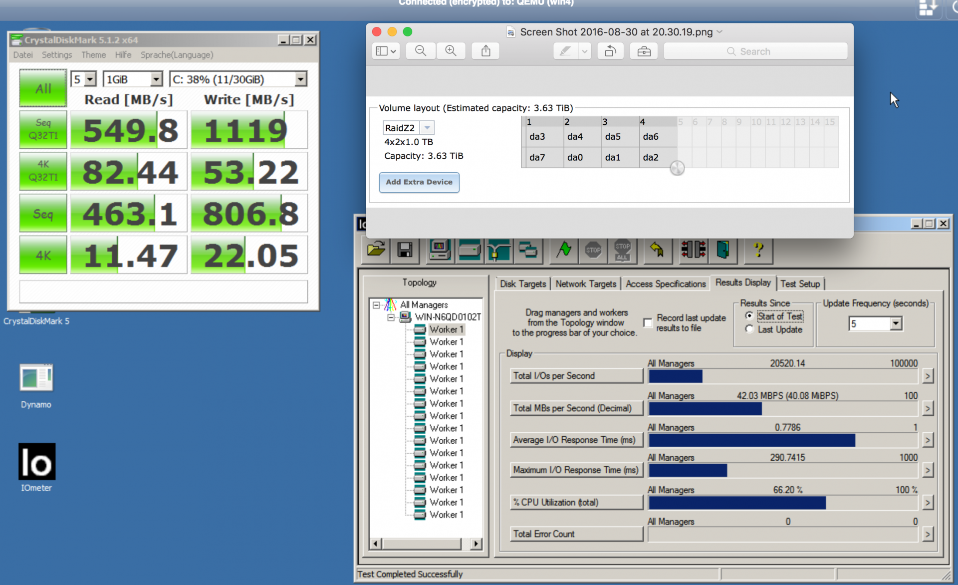

So now I created 5 different pools and ran performance tests.
IOMeter configured with default setup.
VM (2008r2) is on a proxmox Host connected via iSCSI.
Some other combination I can try?
