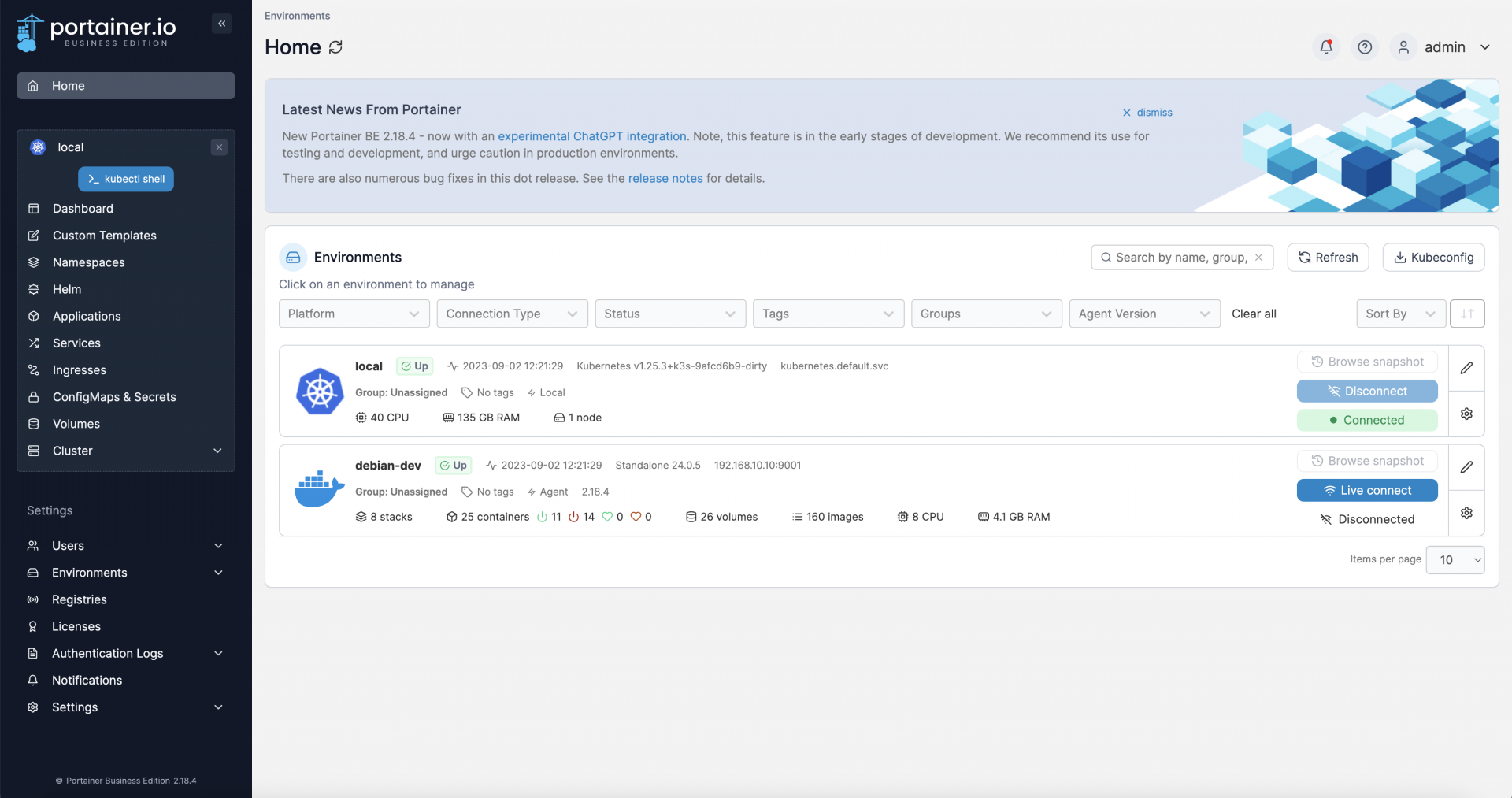

Just want to follow up here too for posterity: after playing around with @jct's catalog and agent, I've gave up and installed flux instead.
Obviously this is outside the scope of truenas support, but on the other hand, with the recent gitlab flux integration announcements + the ability to have kubernetes overview in gitlab + portainer installed as App for viewing/editing local k3s stuff + cert-manager & clusterissuer from @truecharts, flux installed with 3 commands on SCALE console, we have a very strong homelab / semi-professional setup.
One can learn then to do CI/CD from gitlab pipelines and run them on the dev truenas instance with full GitOps methodologies which is what any enterprise does or should do in their production workflows. You can also issue SSL certs automatically and even add traefik routing to your manifests = as close as it gets to any cloud deployment, we use it for hosting, testing and deploying our internally-developed apps.
Here is a very straightforward tutorial that also includes the gitlab agent install through flux-helm chart: https://docs.gitlab.com/ee/user/clusters/agent/gitops/flux_tutorial.html (works on free tier too)
BONUS: I've added my old debian VM with docker-ce + portainer-agent as a new environment to the Portainer App and now can also run docker-compose workflows with AutoGitOps as well.
Probably the only thing left is what happens in case of TrueNAS upgrade....
