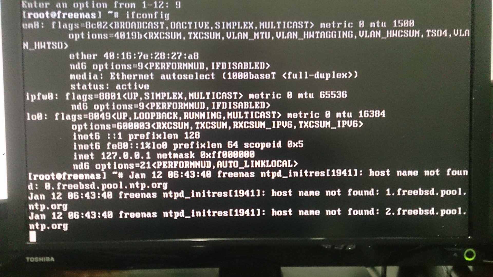

Christopher Joyson
May 22, 2014
105
Hi
Attached as a photo as I have no Network to see the shell.

cyberjock
Inactive Account
Mar 25, 2012
19,525
Everything looks okay on that ifconfig. Of course it's not totally okay since you have no IP. I'd say you're left with 2 possibilities:
1. The Intel NIC in question is bad.
2. Your router isn't handing out an IP.
